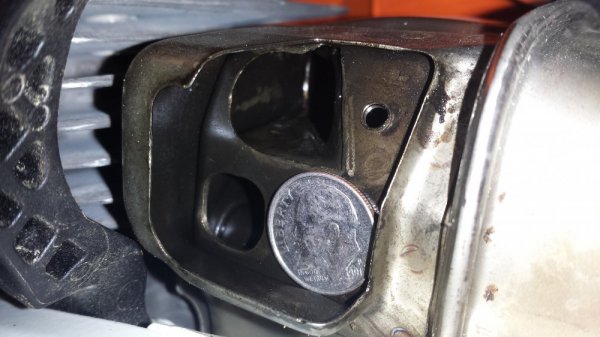

    Here is what is done to mine. There is enough room to just use the area under the existing deflector.

    Did randy pit that second lower hole in? I dont remember that one I dont think?

    Never thought of that. Taking the screen screw out makes it a triple port.:rofl: :lol:

    That is how the 441 has been since Randy did it.
    My 362 I opened the factory outlet, and he added a second outlet. But the deflector on the 441 is bigger than the 362. Lots room for a big ol hole ;)

    Hey, that 3/16 hole may be a power producing port!! PPP while we are on acronyms (another thread) ;)
