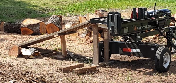

    We had the table already on our 30 ton County Line splitter, but to speed production, we added support legs to table and ramps. 0115221046.jpg

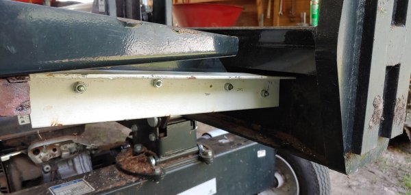

    That will probably collapse. When we first put the ramps on the log catch table, bent the brackets...reinforced those with angle iron 0405201415.jpg

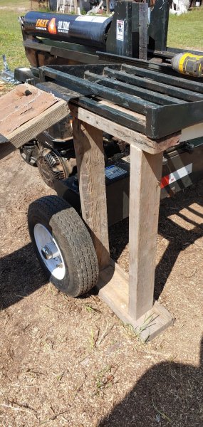

    Then made better support legs for table and ramp 0405201515.jpg 0405201534.jpg

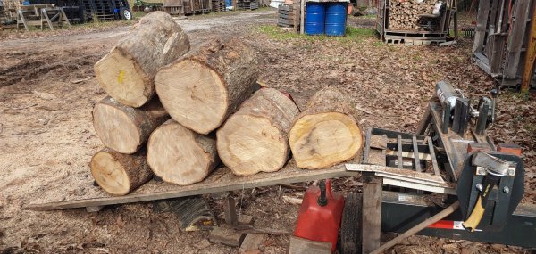

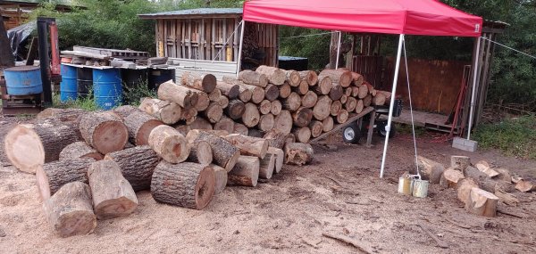

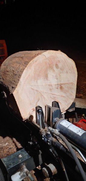

    IMO, this is better than a table, don't have to lift rounds, and can stage a lot of wood to process 0922201856a.jpg

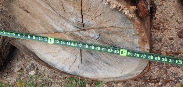

    And we have split some 28"+ rounds on this setup... 1004211724a.jpg 1004212144_HDR.jpg
