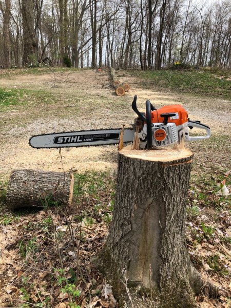

    Cut a bitter hickory out in front of the house today and got the oiler adjusted today where it's using just a tad less than a tank of oil to a tank of fuel.
    Liking the new light bar.
    Had a snafu last evening though. When I put the new bar on I grabbed a chain that looked sharp off the rack. I wanted to cut that 32" sugar maple log in two so I could noodle it down to get it on the sawmill... I was up cutting thru that maple when the chain grabbed... HARD. At that point I remembered why that chain was on the rack by itself... too late though.... It was the chain I had filed real aggressive when I was cutting and making swedish candles from a bunch of dead red pine last summer.
    Crap, that grab trashed the chain adjuster. So off to the Stihlership I go this morning for chain adjuster parts... I hate when I do stupid stuff... Better a chain aduster than snapping a crankshaft...
    Pine filed chains will get MARKED way better in the future... way too aggressive for the Maple.
