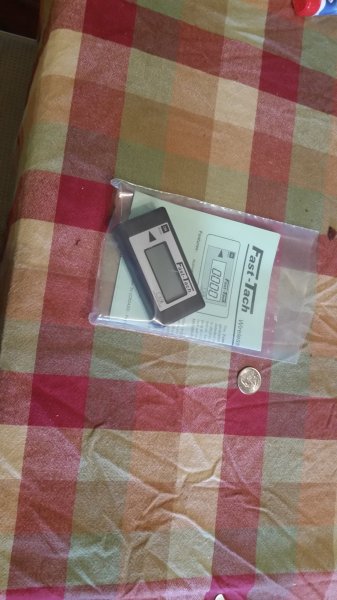

    I have a EDT-8, MasterMech has an EDT-7, and HittinSteel had a Fast Tach (Pretty sure).
    Did it look like this?
    It works.. But has a slower refresh rate than the Tiny Tach and you can't replace the batteries.
    It works great though.

    Oh boys looky what I got here. Figure it was cheaper than me boogering up my main saw. 20141214_111716.jpg
