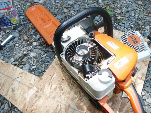

    You got a pic of , flywheel ?

    I will take the starter and clutch cover off today and get some good photos.

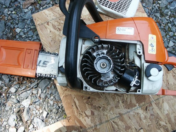

    OK, took the bar side cover off, clutch is free. Remove the spark plug and the flywheel rotated freely by hand. Put the starter back on and plug back in and I tried pulling without the bar and chain on the powerhead and it was jerky, I could pull it out but it jerked each pull, instead of pulling out smoothly it jerked as it came to each compression/exhaust, jerk, jerk, jerk. My friend keeps talking about the decompression valve but I have been told there is none on this saw.
    Here are photos of the flywheel.

    It must be something like Master Mech is referring to, because I do not see anything abnormal from the pics.
