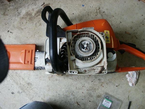

    I ordered new pawls and the saw is not wanting to pull smoothly; I think it is worst now. I tried it with both one and two pawls. I tested before I put the pull cover back on and the pawl(s) were going in and out without any issues. Could it be something else?

    Take the spark plug out and move the flywheel by hand with the starter off and see if it is moving freely. It should only show resistance when you are at the coil and when moving away from the coil. Other wise it should move smoothly.

    One other thing you might try Kimberly is to take the starter off and take a picture of the starter pulley and the flywheel and someone here might spot something that is not right.

    This is the original pawl and spring thing before I changed them.
