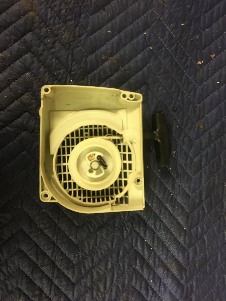

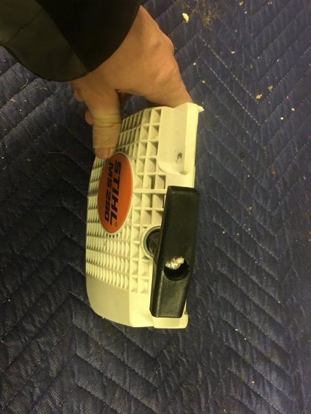

    So, here we have a plain old starter assembly as they come from Stihl for this model. One pawl, standard handle. Nuthin' fancy.

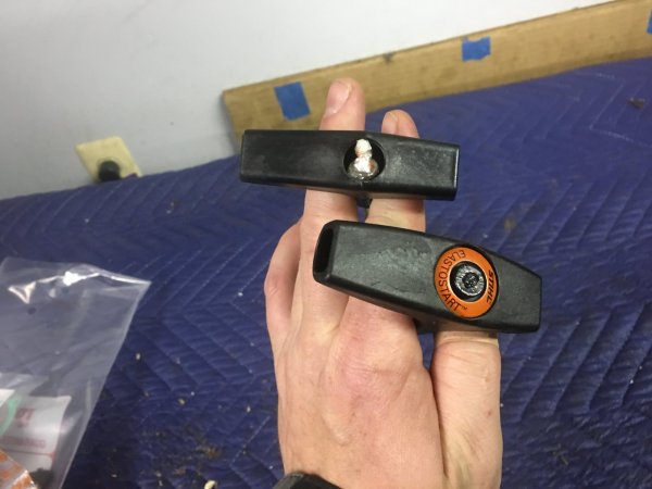

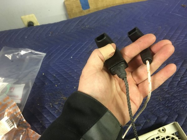

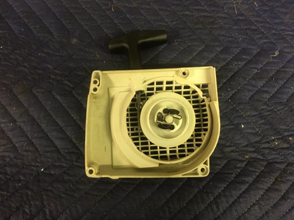

    Comparison of the elastostart handle and the standard version. These handles have either a rubber grommet or a spring inside to absorb the bump of each compression stroke. This stores energy as you pull the rope and that energy is transferred rapidly to the flywheel once the engine pulls over the first compression stroke. The boost makes the subsequent compression events that much easier to pull through.
    And the dual pawl setup. Which balances out load on the rope rotor (pulley), by cancelling out radial forces on the rotor bearing surface and reducing any axial thrust. This should help keep friction to a minimum and allow more of the human energy to be transferred to the flywheel for easier starting.

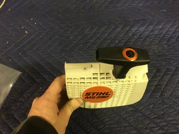

    Here she is, complete.

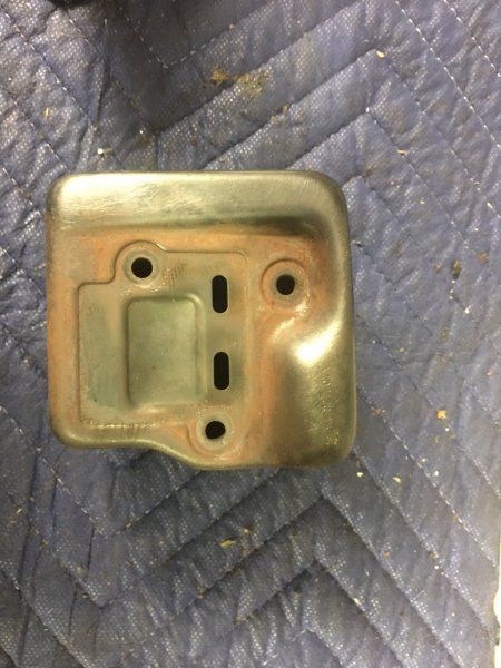

    And for the muffler mod, we have here the muffler as it comes from la factoría. Note the two tiny tic tac size holes and very, very restrictive deflector exit. These poor saws are meant to breathe a lil' better than this but Uncle Sam has his boot on her neck for sure.
    The ovals are for exhaust to exit and the round holes are just where the muffler mounting studs go.
    Yeesh. Even a baby 42cc Poulan has a less restrictive muffler than this.

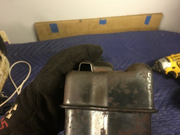

    But with a little common sense and good ol' Yankee hackery, we can screw anything up so here's what I've come up with so far.
    This is slightly different than what I have been doing on these for awhile now but I went god route for a couple reasons. One, it's fast and real easy to do. Two, there is little if any discernible difference in the noise output of our tree slayer from it's stock configuration. You can get even more out of these by grinding out the inner baffle or bypassing it entirely by adding holes in the dimpled area but that will significantly change the dB output and tone of our saw and make it a tad more finicky about it's carb settings at idle. Neither of which are acceptable in this case.
    I also did the deflector a little different in this case as I wanted to see how much area I could get without taking a bunch of material off the front and significantly changing the exhaust direction. I think this gets us plenty of exit port size for this saw and is a more subtle change from stock than cutting away the beveled section of the deflector.
