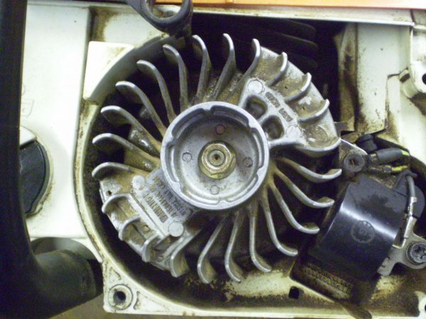

    Take recoil off. Remove spool. Take pictures of plastic cylinder where spool spins. Post said pics. If it's gouged, smooth it with 220 sandpaper after pics are taken. Reassemble, and retry. If no joy, try your other spool and rope on the new recoil.
    That rope could also be too big. Stihl has lots of sizes.

    This is not funny to me, I need the saw working; I need to be cutting wood. Besides, most of the comments have nothing to do with the saw issue. The old recoil jammed like crazy and the pawl was chewed up when I took it off; I spent money on the old recoil trying to fix it and now I have spent money on a used OEM recoil that is hanging up. The guy I brought it from said it was off of a used saw that saw little use. For now I have an expensive paperweight instead of a saw. I don't care if the page count goes to a thousand as long as I can get the saw working. MasterMech offered to look at the saw for me but it would cost a small fortune for shipping.

    Yes, I did this several times pulling the rope out as far as it will go. All seems good off the saw; no hangs at all.

    Like the guys said I think you need to start posting pics? Of the recoil, spool out of it. And of your saw, flywheel side without recoil on? Maybe we will see something you dont?
