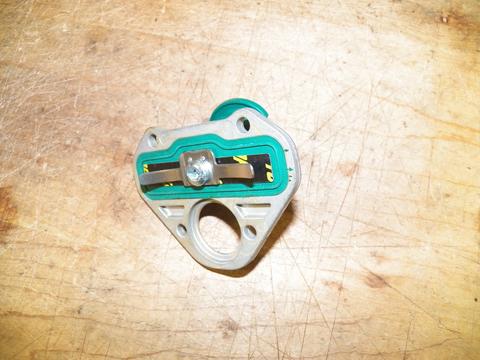

    It is pretty neat, strato with reed valves.
    Note: not my images. My saws not that clean anymore:dex:

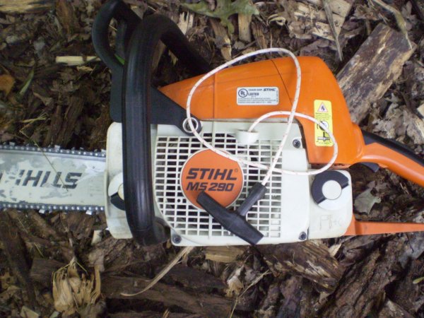

    No joy in Mudville. I installed the used OEM recoil and before I could start it the rope hung. I took the recoil off and got it to rewind the rope and then tested for smooth operation off the saw, installed it back to the saw and went to test starting. Put it in choke, pulled a few times until the sputter, put in run position, pull the rope, and the saw runs but the rope hangs again so had to cut the saw off. What is causing this? And please no comments about I don't know how to start the saw because I have started this saw many times since it was given to me.

  14. clemsonfor
    clemsonfor
    15,996
    37,478
    Greenwood county SC
    Seems like something is binding.
    I have no idea. Hope one of these guys can point you in the right direction.
    Only thing I can think of is that the recoil spring is not wound tight enough.

    Thanks. I don't think this is the case; the spring on this recoil feels stronger than the one on the old recoil that was giving me trouble; one of the first things I noticed was the spring seemed stronger than on the old one.

    I took the recoil off; it was binding off the saw; turned the spool to get it to release and the spring to pull the rope back in. The rope looks really clean although the recoil case has some scratches where it would be against the ground; wondering if the rope could have been replaced.

    I was wondering if there was a replacement rope on it and may it is too large a diameter rope?
    Is the rope the same size as the one on your old recoil?
  18. Kimberly
    Kimberly
    Mar 19, 2015
    5,072
    12,819
    The Kangaroo State
    I think so, it is a white rope with orange stripe; isn't that the Stihl rope design? You can see it in the photo I posted earlier.
