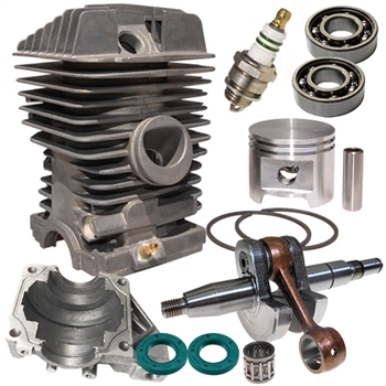

    Baileys short block 159.99 ..... lotta work to save $10 ! No thanks - not worth the time on my end ! Beerwhoop!!!

    Read the customer reviews on this product in the link above .... we’ve used the Baileys kit and while not the quality of Oem it’s a viable solution ... have taken throwaway 290s and breathed new life in them for 159.99 (and went from 55 to 64cc) and more importantly for FAR less time ... STIHL gets 2+ hours on top end and that’s with everything being clean and a trained tech with all proper tools ... a guy doing it himself for the first time is gonna take longer ... your mileage may vary!!!
