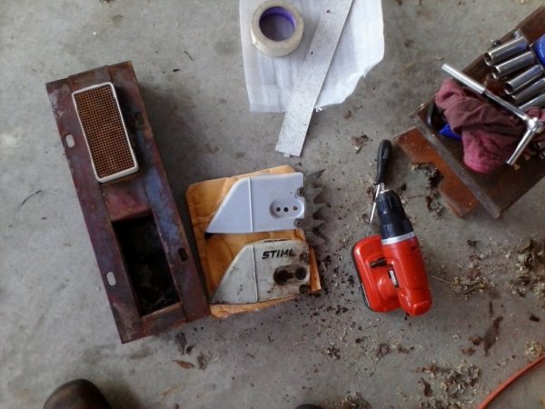

    According to the IPL there are 3 different sets of dawgs that came on the 066.

    I will get the part number on what I have then see what set its from.

    I have a 660 ipl

    The spike I have has an old part number on it. 1122106, which matches the 1122101 outer. The new PN for these are 1122 664 0506 and 1122 664 0501. The 066 IPL shows that they fit both the large and small side covers.

    I have both the 066 and 660 IPL, and they are the same on that page for PNs. Illustration G, Chain Sprocket Cover.

    I have the outer one 1122 664 0500

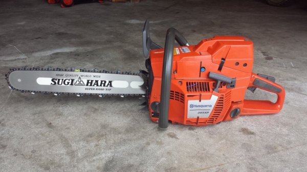

    Shaking head. Midwest Shrimpy Bar Disease! Complete waste of torque, unless you are cutting something like dry eucalyptus or madrone.

    No use cutting 16" logs with a 36" bar either. It all depends on the job ahead of you.

    Well, if you want to use that kind if logic, why reach for a 90cc+ saw for cutting a 16" log? I just do not see a job for that setup. I do not advocate that everyone run a 395xp with a 36 inch bar (your words, not mine), but they will run them. I would see no problem with cutting a 16 inch log with a far more reasonable 28 inch bar on that saw, which is what I would likely use.
    There is obviously a paradigm contrast between Midwest and Eastern vs. Western fallers regarding bar length. As such, our debate will never be resolved. However, the OP is very extreme and bizarre. That TarzanZipLines fool is tweeking bars so far beyond their engineered design that it is absurd, even in terms of the western long bar paradigm.

    This confuses me? :confused: You guys out there won't think twice about running a 28" bar on a MS361 but 36" is pushing it with a 395XP? :rofl: :lol:

    Dang, I started coveting as soon as a I saw that picture! I love that saw
