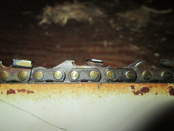

    using 3/16 file. Didnt need the sharpening, but fourth time its been sharpened.

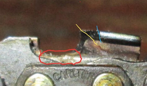

    Everything in red should be filed down to the tie strap.
    Blue shows your cutter angle. Lower the whole file to create more hook like the yellow line
    10° down angle on the file handle is a good thing. It makes the working corner stronger and the outside of the cutter sharper to help self-feeding.

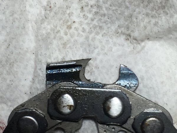

    Heres a pic of a good cutter to try and mimic
    Chaz, bear 1998, MFMc. and 9 others like this.

    my old .325 16" Oregon chains had a good hook like that and i was using a 7/32 file to sharpen. I could file "deeper" I sharpen free hand using only the file. I decided to buy some 3/16' files and use the correct size.
    Is the pictured tooth hand ground or machine?

    The pictured cutter is from a grinder, but it's the same for filing. The proper file size will require you to file the gullet after sharpening the cutter. You shouldn't be able to reach both in a single pass

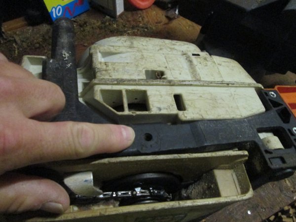

    Checked under my circa 2010 MS290 and this looks like an oiler adjustment farmer steve IMG_1088.JPG
    Thanks for the sharpening tips huskihl .:yes: Just when i though i was a decent hand sharpener too!:picard: I turned the oiler screw up a tad and noticed the stream of oil was better.

    Yep, that's the oil adjuster. Our 029 is adjustable.

    I was wrong.:picard: My 290 does have the AO. Hard to see the hole in the handle. Not the same place as my other saws.
