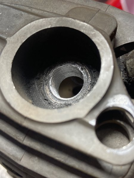

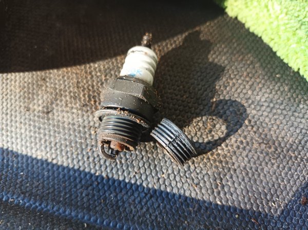

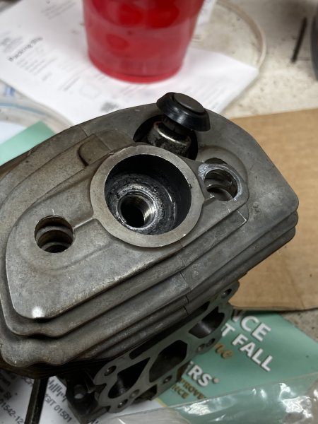

    It seems to me that the helicoil is way more than 1mm wider just based on the image of the tap they use. Or maybe I am wrong. Anyone know how big the new hole is? I'll clamp it into the vise and see if I can unscrew the helicoil. That must be it.

    Good eye and that would explain it.
    I have a helicoil kit. Do you need me to measure tap or check drill size?

    Well I'll be dammed it was a helicoil after all!

    Just put in a helicoil on a 562 a couple months ago where the plug was just rattling around, destroying the the cylinder threads.
    369494A8-7B5F-46E0-8359-37154319F46F.jpeg 4DFA2169-BF87-43ED-86C4-5AC7E2D169E0.jpeg
    Didn’t figure how a plug could get that loose without some human performance issue.
    I guess I’d go with oem spec unless there isn’t enough purchase, then go with what will work

    I think I take apart the saw first and inspect the crankshaft and condition of the piston. My guess is it's probably easier to just order a Meteor piston/cylinder kit if everything else checks out.

    If it's just the spark plug hole bunged up, I'd go for a sleeve-style spark plug thread repair kit. Nothing runs better than the OEM cylinder - usually.
    When using that style kit, installing the correct insert at the right height is critical. Do not leave the edge proud of the sealing surface, and do not have any insert hanging into the cylinder.

    It appears they sold you a plug for the 201T, not sure though. I know the 201T plug threads are smaller than the 200T.

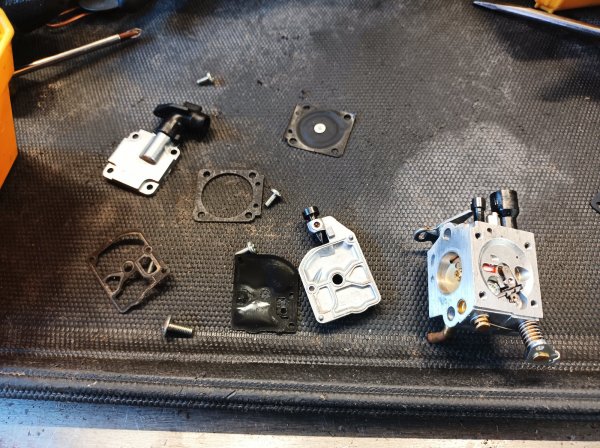

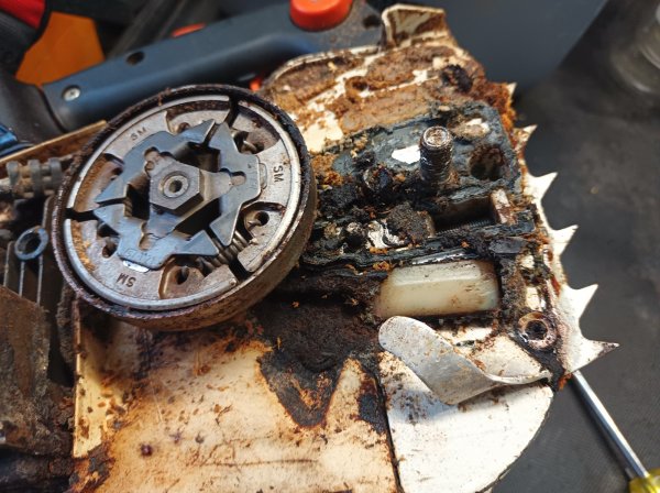

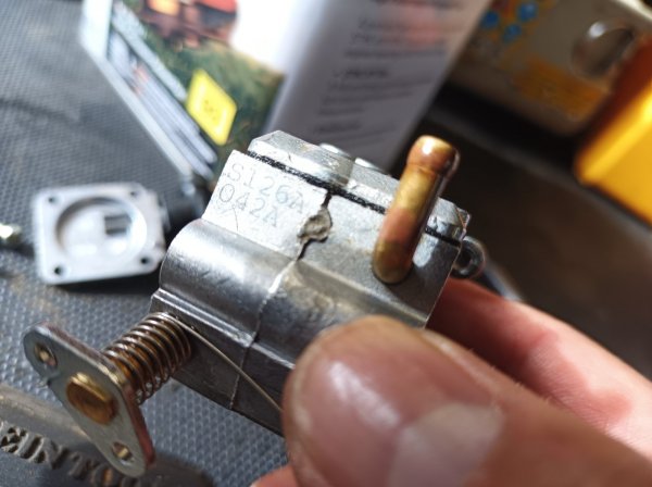

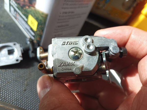

    The good condition MS200T is up and running. After cleaning it all up I filled the tank only to find that the fuel line was leaking right at the gasket seal. Turns out the old line had stiffened up to the point where it no longer made a nice seal.
    The carb also needed a gasket kit (RB69 for the Zama carb) and that worked like a charm as well. Tried to run it without doing that first but it just didn't rev properly and was bogging down. Felt like a fuel supply issue and indeed it was.
    Here's a short video of it running minus the bar and chain. The chain brake cover was so dirty it's a good thing I decided to open up that inner panel. Holy moly it was crusty and disgusting.

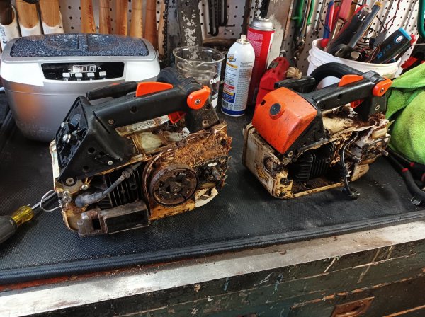

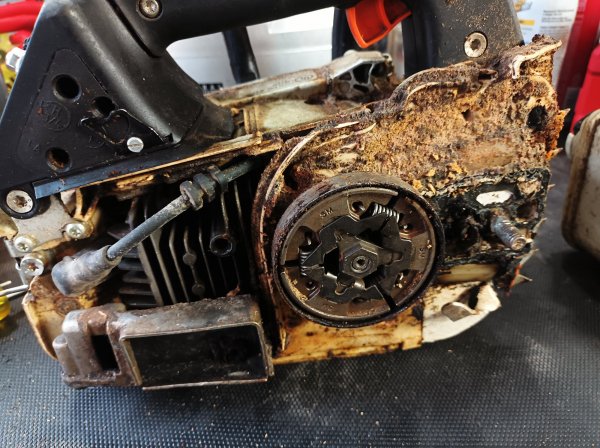

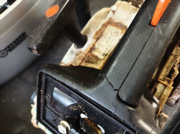

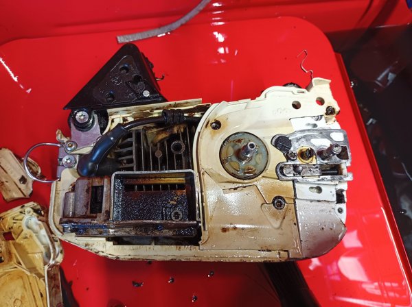

    Setting aside the helicoil ms200t for now. Got the second set of twins. Good compression on one with a broken handle. Bad compression on the other with a good handle. I'll swap the handles and see if she starts. But holy moly the good compression one was caked with spruce/pine sap....And that stuff is black BLACK.....and I had to do a lot of scraping with a flathead and a steel brush to even find the screws for the ignition coil.

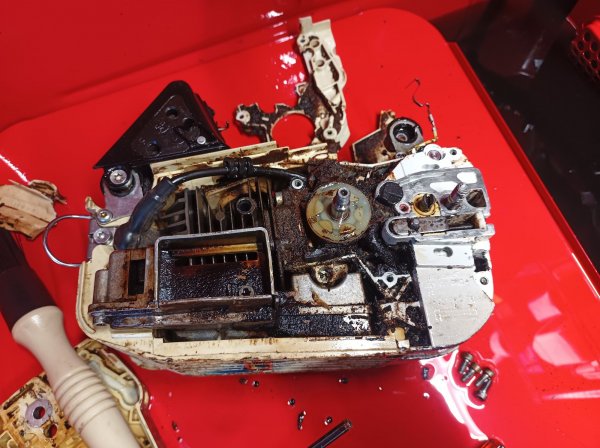

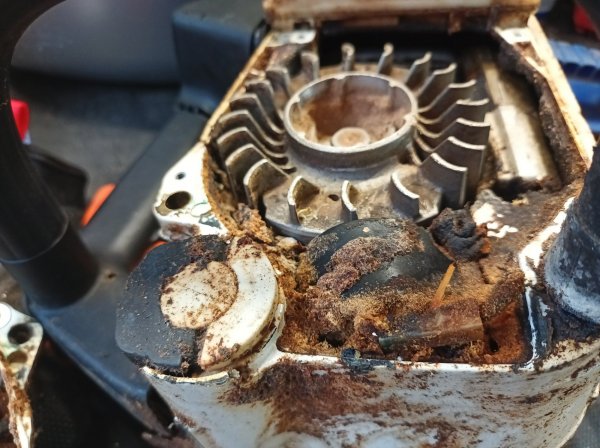

    Nasty nasty nasty
    Looks better in the first pic....but then I decided to take those covers off.......

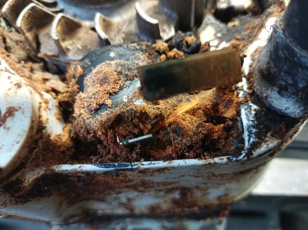

    And this is what was underneath. Yikes.
    SimonHS likes this.
  20. buZZsaw BRAD
    34,736
    214,826
    :bug: WOW! I think caked is an understatement. Like a time capsule of crud. That softwood sap is some sticky azz stuff.
