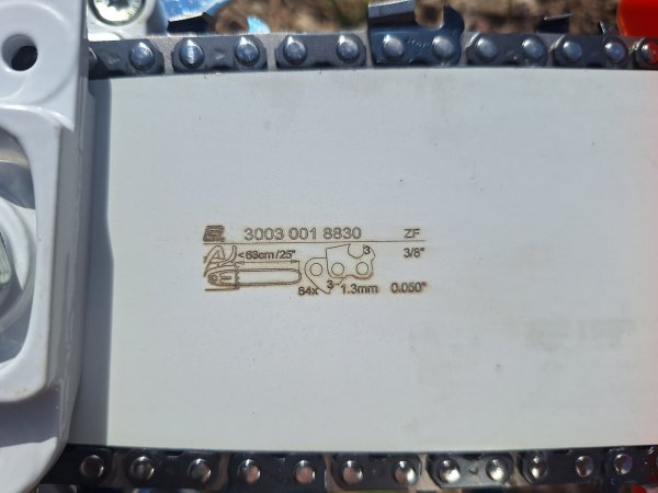

    This is the bar and chain it came with:

    Here is my next question... you have been gentleman so far, so laugh, but not out loud.
    I want a 20" bar. This 25" bar/chain is 3/8" pitch, .050" kerf.
    I have some loops of 20" 3/8" pitch, 0.063" kerf.
    Is the sprocket able to use different width kerfs as long as it is 3/8" pitch?
    metalcuttr, Screwloose, Mrxlh and 5 others like this.
  4. Chud
    Chud
    Aug 15, 2020
    7,342
    54,804
    NC
    Yes

    I would stick with 3/8 .50. In my experience it’s hard to find .63 in a brick and mortar. If you buy a .63 bar than you gotta stick with .63 gauge.

    X2. The only 063 I run is on the 261 and I think the 026 & 028 have it as well.

    3/8 .063 chain is more common for bars 36” and longer
