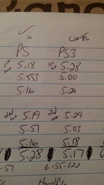

    Remember folks. These are "average" times. One bad cut (which is what made PS lose) will throw the results. I pushed to hard on the 2nd cut of standard PS. Here are the times. The 1st and 3rd cut of PS were faster. The 2nd cut raised the average to .11 slower. . . That is a tenth of a second. None of your eyes will see that. A half a second is hard to notice by hand.
    The PS and PS3 are the same cutter. So using it in a flat cutting style, should yield the same results. Try bore cutting with the PS3 and you'll run into some problems. That extra bump is a killer. LOL..

    It's not necessarily faster than PS. There are a LOT of variables in chain testing, especially chain that has been sharpened. However PS3 is very good chain and should be nearly as fast as PS as long as the nose of the bar isn't buried in the cut.
