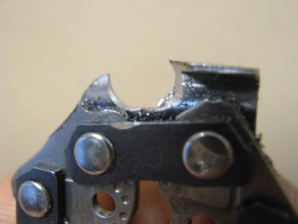

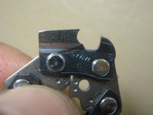

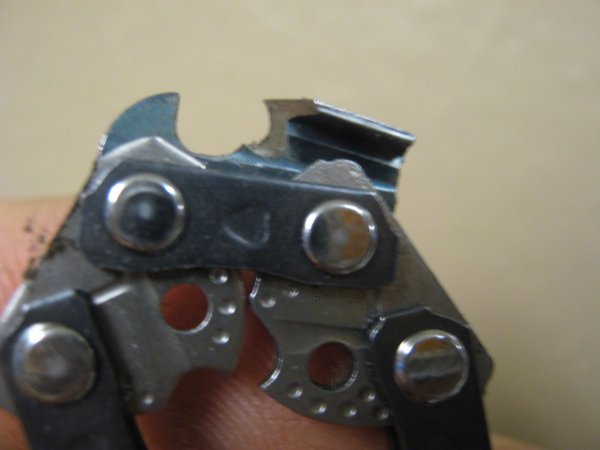

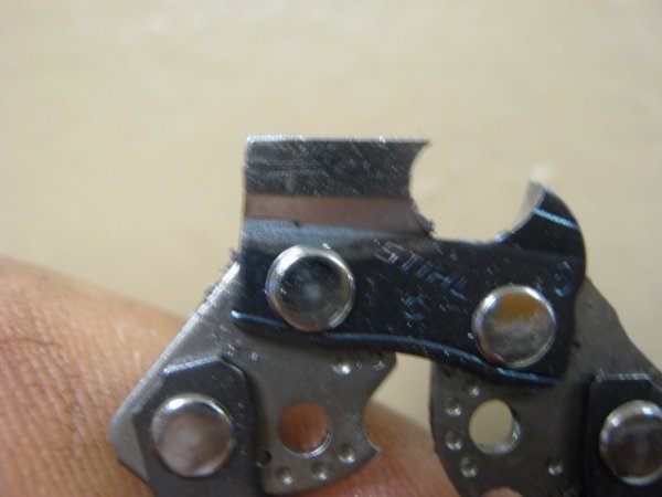

    Hedgerow, I purchased 2 PS chains and after taking a close look I see what you mean. They are nasty little boogers. I'm not for sure if there is much to gain, round or square. The factory did a great job with a nice hook, angle under the top plate, and sharpness of the top plate. The only issues I noticed were different cutter lengths, which I find common on new chains. But never as sharp as these OTB.
    First 2 pics are OTB and second two are my attempts to improve with round filing. I tried for a complete arc down the side plate and I achieved a little bit more radius under the top plate. Tomorrow I hope to bevel file another. Test will soon follow to see.

    They are sharp little buggers, but what I find most interesting is the factory raker height......... 0.017
    PullinMyPoulan and DexterDay like this.
  17. SquareFile
