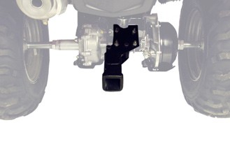

    I went with that hitch setup because the ball hitch just mounted on that flimsy piece of metal off the LT bent on me. I didn't realize at the time raising it up and extending it out would have this impact. If I go this route I am thinking something like this might work best. It would be securely fastened to the back plate of the LT and lower to the ground.

    I've seen this exact item and actually I think I have in my cart on Amazon. I was going to pull the trigger but held up as it's another big and bulky thing to store, but that would surely work, thank you!

    They sell ones that just screw down into the ball hitch hole, but tons of bad reviews stating that no matter how hard you tighten that bold it still swings. So I am looking into something like this, much more robust it seems.

    If you buy a hitch for the Rancher, get something that doesn't just bolt to the factory hitch...especially if it hangs out there a ways. The ones that rely on the strength of the factory hitch, and stick way out, have a history of bending/breaking the factory hitch off if used heavily. The ones that also attach to the swingarm are a much better design...just don't put a long receiver in it...don't want to find out if you have any good welders in your neighborhood. Plus, if you crack/tear the factory hitch welds open there is a chance of getting mud/water into the swingarm/axle tube...which allows it direct access to your axle/drive bearings...not good!

    Thanks brenndatomu ! I think if I get a hitch for the Rancher I am def going swingarm :yes:
