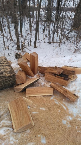

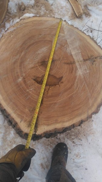

    I hand split everything, For the big ones I always have to work the edges and normally once you get that first split off it goes much better. I almost never use a wedge and never had luck noddling. I use The isocore mual.
    Here is a big red oak I did, split the whole tree by hand, only have 2 rounds that were pure knots that I couldn't do by hand.
    That is one round, they are all cut to 24"
    Red oak.
