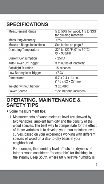

    I checked with General tool to see how their meters are calibrated and for what temp. They sent me a copy of the spec. sheet for my meter. And said it works in a range of temps.

    Yes, they operate in a wide range of temperatures, but they are typically calibrated to work at 68°. The delmhorst brand are calibrated to provide correct readings from 50-90° those are pricey though.
    Point number 3 on this chart
    8 Ways to Check Your Moisture Meter’s Accuracy
    And this is the temperature correction chart.
    Species Correction Table
    Less expensive ones like most of us use, don't have that wide of a window of proper operation. Spending $500 on a MM for firewood use is a bit excessive, especially since it's just a reference to back up what we know happens after it has been css'd a while.
    I was a biology major, and work with our engineering department, so I'm a stickler for using tools as they are intended. :handshake: :yes:
