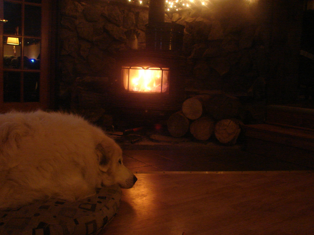

    Just asking Bill. But why would it matter if the dry adhesive is flammable underneath the non flammable thin tiles?
    Pretty sure Marvin is good to go with his setup.:salute: But then again one of the furry pets might be a flaming problem.:hair: :coldone:

    Talked with the insurance lady when I installed the hearth and figured thicker was better so went inch and a half cement under the rock as they were worried about the embers.;)
    Canadian standards [cited below] recommend the following floor protection:
    Any combustible flooring or floor covering beneath a solid-fuel-burning appliance requires protection from hot embers that might fall during fire tending or ash removal.
    Combustible floors must be protected by a continuous, durable, non combustible pad made of a 0.38 mm (0.015 in) thick metal sheet , or a grouted ceramic floor-tile installed in accordance with the National Building Code of Canada shall be considered a durable pad. Floor protection pads must extend not less than 450 mm (18 in.) in front of the loading door and 200 mm (8 in.) beyond the other sides and back.
