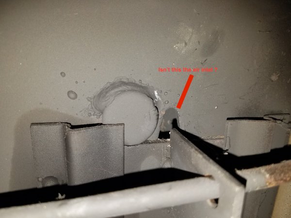

    There's a round disc welded to the "ceiling" that stops the slide between the two angle iron supports from going too far back. To the right of that is the pointy end of a triangle that is the air inlet. It isn't closing it off completely.
    It might be a "safety thing" to stop a user from choking a fire down to nothing and creating creosote. Great in a test lab. In the real world it might not work as needed.
    That's what I'm seeing.

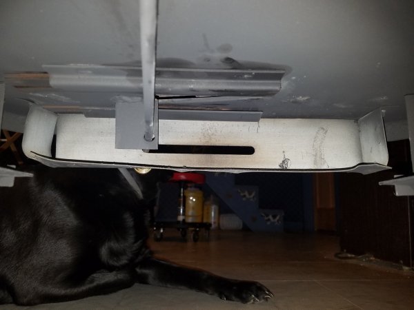

    There is a thin piece of sheet metal that guides the primary air handle. It was bent a bit from when I picked up the stove from the previous owner. He used a small tractor and straps to lift it on to the truck bed. I noticed it was bent a bit but never thought much about it. I dont know how I've overlooked this for so long:doh:

    I'm not seeing what is bent.
    Chaz, Maina, saskwoodburner and 4 others like this.
  10. brenndatomu
    25,337
    164,985
    I don't think its in the picture...
    Chaz, Maina, saskwoodburner and 3 others like this.

    It's not in the picture billb3. I'll try to take some pics later.

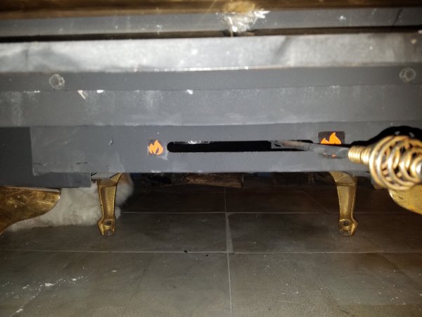

    Well I took some before I saw this post so I'll put them up anyway haha.
    Here's a pic from the front. The handle itself was bent slightly as well. I got that taken care of. Dont mind the cat in the background....
    Here is a pic from the rear of the stove. As you can see it is not factory straight but better than it was. I didn't take pics of before I "straightened" it so you'll have to take my word that it was worse than this. Got the dog in the background of this one...

    I see the problem now.
    You need a smaller flame icon on the left side of the air control. :D

    Well after doing some bending and such I thought I had it figured out last night. Before bed I loaded her up thinking I was good to go. Boy was I wrong! I was up til about 230 babysitting the stove. Then I was back up around 6 with the house temp measuring 63* :headbang:
    I placed a magnet over part of the primary air hole that is open even with the air totally closed. It is not completely covered but it seems to have made quite a difference today. We'll find out tonight.

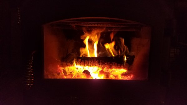

    Are ya still getting the rocket down in front Marvin?
    Up in Rocks picture he has the same thing going on but with the air full open.
