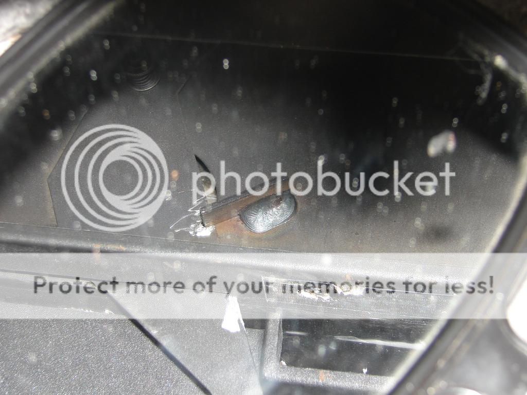

    All I'm getting at is if everything is shut tight the rocket ya got going on the bottom of the fire seems to be getting quite a bit of air. Pretty hard to have a good nights snooze if a guy has to worry about a Turbo brewing in his stove. :coffee:
    Not everyone here agreed with me modifying my stove with the dremel but it did work and the stove cruises great for the time at sleep or at work.:coldone:
    Didn't have to groove much out to make a big difference.

    Loon can you repost your pics? For some reason I can't see them

    They come up for me...

    And just so we're clear on what I was trying to get across, my air lever had full range of open/close, but the plate was dropping down on the leading edge of the primary air hole. If we used Loons photo for reference, imagine the edge of the plate he dremeled being raised a few millimeters in the picture. I just can't believe how good your stove breathes with the damper. Hopefully a different technique will get you into more moderate fires.

    Yeah I'm seeing them now as well. I dont know why I couldn't earlier.

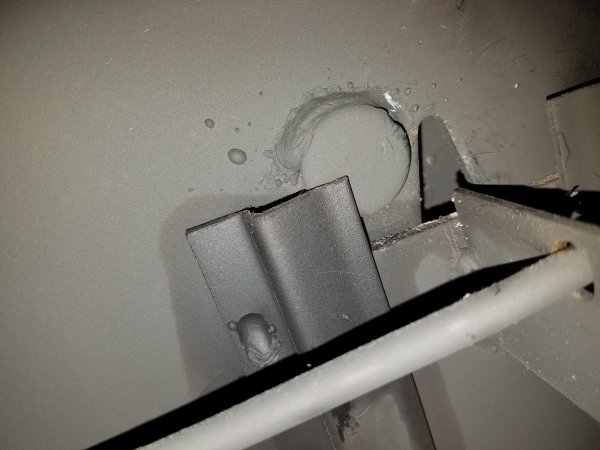

    Well I'm starting to think I'm losing my mind. Maybe I have to go back to the Bill Engvall thread I started.
    Below is a pic of the primary air damper fully closed. Notice anything? I dont know how I missed it before.
    Here is a pic after making some adjustments....

    Looks in the pic that it aint stopping any air? :hair: :coldone:

    I'm visually confused by what I'm looking at. Can somebody explain in small words or arrows please.:rofl: :lol: That hole thingy supposed to be punched and the other thing rides over to block?

    If that round thing welded on is a mechanical stop I'd probably be cutting or grinding a little bit off at a time to see effect ( or taping the opening )
    Got any magnets around you can at least partially block that opening with ?
    I'm not familiar with that stove to know if that inlet also supplies air to the tubes.

    It does not supply the air to the tubes. There is an opening in the rear of the stove that goes to the tubes.
    Now that I have that straightened out I will be partially covering the hole incrementally with a magnet if necessary. Hopefully it wont be needed but we will see.

    Yup, I'm bettin that makes a difference!
