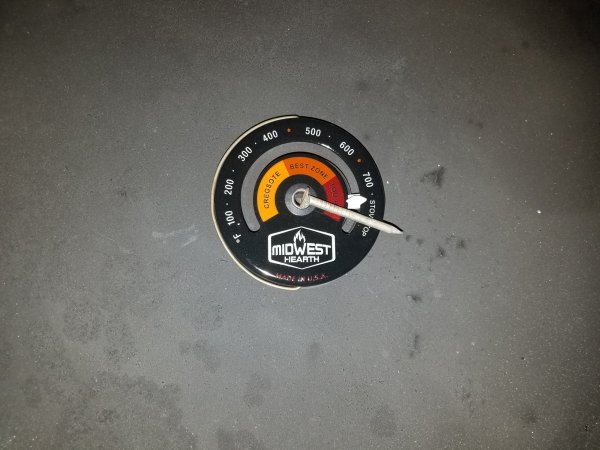

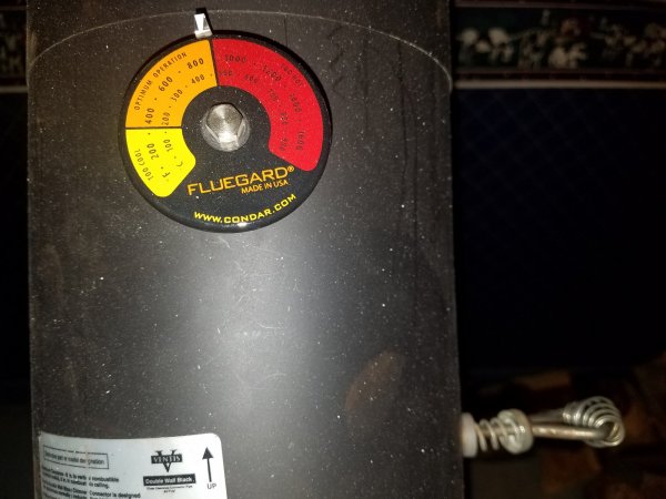

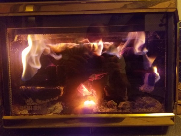

    Yesterday I installed my new door gasket as well as a new glass gasket on the center piece of glass on the bay window. My stove now has all new gaskets. It has definitely helped as far as how much control I have over the fire. However it still burns way hot.
    What I usually do is load up the stove when the STT is at 400* or below. I will run it wide open until the flue temp hits 500*. At that point I start cutting the air back in increments.
    Even with the primary air shut down and the damper closed my flue temp usually reaches around 900*. The STT peaks around 750-800*.
    I'm not worried so much about the STT, I just feel like I'm wasting a lot of heat up the stack with flue temps that high.
    Any suggestions? Pics below are with air closed down as far as it will go and pipe damper closed fully.

    Every stove and every setup is different Marvin but we can all learn from each other’s experience. I don’t think anyone can reliably tell you how you need to run your stove, but hopefully you’ll get some ideas that you can try and find something that works in your situation.
    The only time I run the pipe temperature up to 500 is on a cold start. On a reload if I catch it before the STT drops below 250 I just leave it open long enough to spread flames through most of the load and I see the pipe come up around 300 then I engage the cat and set the draft to about half immediately and lower it from there over the next 10-15 minutes. That way my STT climbs at a nice steady controllable pace.
    If I want big heat fast I let the pipe get back up to 400 before I re-engage the cat and it will usually climb to about 500 before settling back down, and the STT comes up quicker as well.
    I used to run the smoke dragons like you describe in order to get the temperature up and burn off some creosote before choking the fire down again, but that’s old school thinking that doesn’t apply to an EPA stove. I don’t know if that’s what you’re thinking, but old habits do die hard sometimes.

    I suppose that could be my problem. Maybe I'm not cutting the air soon enough. I know my tube stove will run differently than your cat stove. I'm just asking about general advice. I have just been puzzled because the flue temp consistently runs 100-150* higher than the STT since I installed the damper. I would have expected it to lower flue temps. I know brenndatomu has mentioned flue temp should drop as STT rises when you cut the air. I'm just not getting that and can't seem to figure out why. Sorry I'm just rambling at this point :picard:

    Marvin .. My friends have a tube stove.. I've never seen anything that high.. I am very curious if you have excessive draft. The damper should solve that.:sherlock:

    Give it a little time a closed damper should almost take the fire to smoldering. Unless there is a major leak somewhere. Crack in stove body? Broken weld? Etc?

    If you are re-loading when the STT are 400*, you must have quite the pile of coals...that will make your new load off-gas HARD! Waiting until you have less coals, and cutting the air back sooner will help control things a bit more...

    I haven't read all the threads, but it sure does seem you still aren't controlling the air.
    I'd be checking that the stove's draft control was actually working right. Maybe even finding where it comes in and blocking that off a bit if the opening seems rather large.
    If I shut my air off to the stop the fire almost goes out.
    Different stove, but still ...

    Marvin .. I am less worried with your stack temperature because it's a probe. My thermometer on single wall reads half of probe. Needs to read 275 or 550 real temp before engaging cat.. IF your tubes are burning all particulate, its just warm air going up. Hard to capture all heat.

    I normally try to reload around 250-275 F stove temp when the coals have hung around for awhile and the stove temp is dropping slowly. This is the best way to stretch my wood/heat cycle. When more heat is needed or I try to reset the clock on babysitting, I'll reload at 300-325 stove temp. The warmer the stove is/has more coals, the quicker I tend to throttle back the air. As in, immediately on a hot reload. I know it goes against conventional wisdom (and people will argue against what they don't want to understand or goes against what they believe even if its true) but there's more to making a fire than running stove to 500 and shutting down air in increments, or char all wood, and then turn down air.
    Next time you do a hot reload (bunch of coals, and 400 F), put wood in, close door, throttle back air half way and see what happens. Everyones system is different, but if I had to guess, this is how it might go. Your wood will sit there for a minute and do nothing. You'll see some smoke curling up from the pieces touching coals. Suddenly you get a starter flame that ignites any smoke, or you get a northern lights firebox whispy fire. It might stay or might stall and happen a few times before it stays lit. Shortly, or eventually depending on your draft, the fire is going well. Shut down air some more. Who knows might work or might not, nothing wrong with trying.
    Have you verified by eye that the air plate that regulates air attached to the air lever is physically closing and blocking the air? I had that problem before, and it made my stove breathe way too easy.
    I'm rather amazed that your stove can continue to climb in temp with air full back and damper closed.

    If this is with everything shut tight? I'd say your primary is still open quite a bit. Can you see the plate under the stove?

    Yes I have verified the primary air closing. It is in the front directly under the door.
