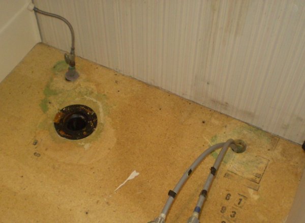

    I got the sink base out, the toilet is out, and the vinyl is up. I had thought the flooring had deteriorate but it had absorbed so much moisture that it had swelled and buckled. I looked down through the hole where the sink lines are located and could see two elbows, and two tees. It looks as if the elbow is weeping; probably for years and the water just slowly accumulated under the floor. There is a heavy polyethylene barrier under the insulation; which is probably there to prevent moisture from rising from the ground and penetrating the insulation. This barrier acted to hold the water leaking from the pipes. I kick myself for not redoing the plumbing in the house but of course at the time we had limited funds and was told that the lines were done differently than the ones in the class action lawsuit. The crimps on the lines are aluminium; which can corrode and weaken the crimping action. If one of these crimps have failed, then others could fail. Therefore, I have decided to replace the water lines with PVC. That will mean opening up the wall in the foyer to get to the shower lines; I am hoping I can remove that section of wallboard without damaging it.
    One issue is that the wall behind the toilet and sink is not sitting over a sleeper. It is not a load bearing wall; just a partition wall. If I cut the flooring up to the wall, then that section of the wall will have no real support under it except for the damaged flooring. It this had been a plywood subfloor, it would not bother me as much but it is this particle board subflooring. Putting any kind of support under that section may not be easy. In the photo, the sleeper is just behind the hole where the water lines come through for the sink.

    I cut an inspection hole at the water lines. This particle board subflooring is glued to the sleepers and then nailed. There was a hump in the floor but that hump may have always been there as far as I know. I am going to cut out between the sleepers and remove that part of the damaged floor. Then I can nail some pieces to each sleeper to have a nailing surface for the new flooring. The old floor along the wall will be left in place; the worst section was where the sink was located. I can sand and fill so it is level and I think I will just put sheet vinyl back down. The toilet never flushed properly since we set the house up and it is because there is a long horizontal run across the house; as they say in the business, crap runs downhill. Therefore, since I have to open up and put a new toilet flange, I am going to cap off that sewage line and run a new one.
  12. Kimberly
    Kimberly
    Mar 19, 2015
    5,072
    12,819
    The Kangaroo State
    No, I was wrong, there is a sleeper at the wall; that is a good thing.
