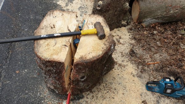

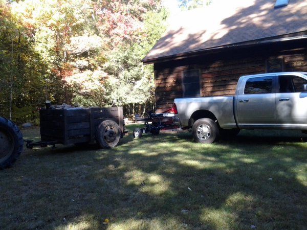

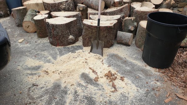

    I like having the MC especially for those times when you find out something is not ready to burn that you were certain was ready. Saves you some headache later on. It's also super useful as others have pointed out if you get a load of some wood that has been lying around for some time, or if you scrounge and find something half dead, etc. It gives you a nice starting point. That's another reason why I try to keep the same wood from the same load in the same stack.....Doesn't always work out that way.....but for example I have two holz hausens of spruce from the huge score I found on the side of the road right after buying the truck.
    I know if I check a few splits, it's pretty indicative of both of those stacks (~5 cord) and thus one doesn't need to check 1000 splits.

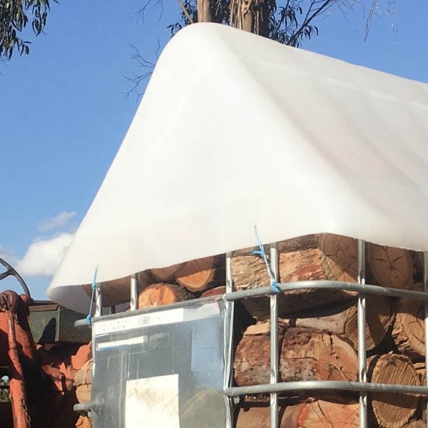

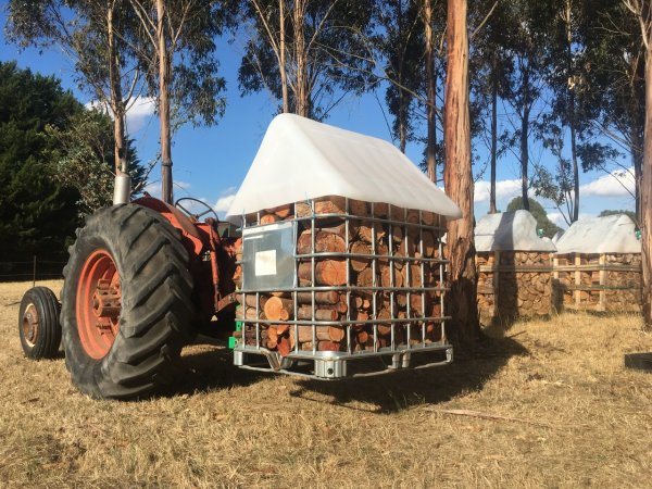

    G’day LordOfTheFlies, the short explanation is, I stack my wood in to IBC’s and cover with a roof made out of half of the plastic liner cut diagonally.
    I then place them in spaced rows Out in the hot Aussie sun to bake for a few years. The wind blows through there well too
    When I need firewood I just drive down the paddock with the tractor and bring a tote back to the shed and remove the plastic roof. Job done. It removes a lot of handling.

    Ah you're the guy with the diagonal IBCs! Ha! I only have 6 of them, 4 with the plastic that I use for kindling. I remember now you posting pics of this.
    Very nice........it's a bit less humid down under, n'est-ce pas? Than say here in the Northeast where it can get just dreadful at times.....like last week.
    I would love to have enough land to warrant a tractor (and numerous other toys). Maybe one day..........

    How do you secure the IBC tote lids so they don't blow away in high winds?

    I just drill 4 holes near the corners and tie them to the tote with bailing twine.

    Self tapping sheet metal screw into the top rail in each corner is how I did it
