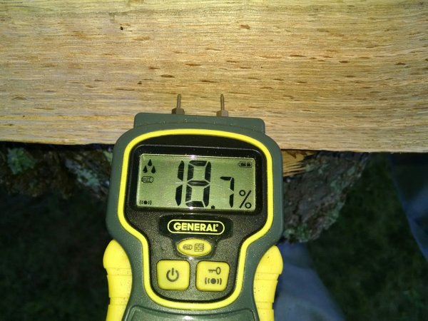

    Ok. I have some red oak that was CSS'd, 3 years ago, that I was planning to burn this heating season.
    The rack has a fairly sunny location and the ends all greyed out.
    I know it's there for 3yrs, due to my highly sophisticated dating method, when css'd
    I took a split and split it again. Moisture meter says :
    I should be good to go.

    29,225
    166,829
    Except the difference is now you actually want to know what the MC is ;).
  19. Horkn
    29,225
    166,829
    That and you take a reading from the inside, where any moisture will be.
    This is one reason I like MM's. Truth will out.
