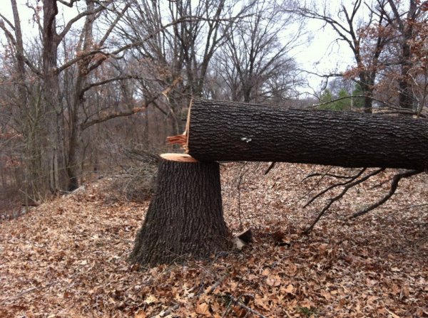

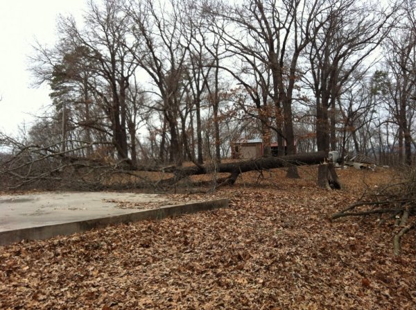

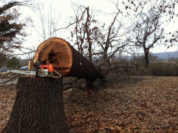

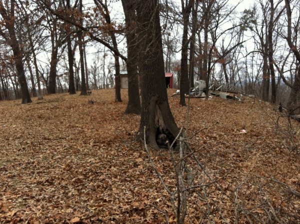

    29" DBH Red Oak. Hollow, hanging over the location of future shop. Other than the hole and being a little hollow, easy tree. Landed just where I aimed it. Critique please.
    That's my house in the back ground.
    Of the second pic, NOT the first:D

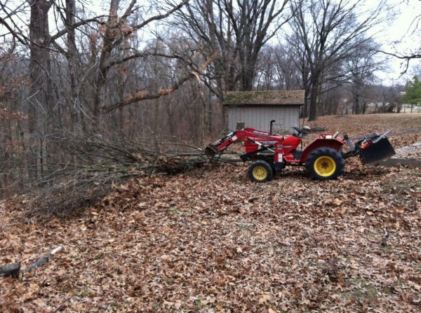

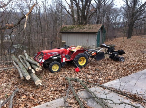

    image.jpg Pushing brush with my homemade forks.
    Neighbor called wanting a "rick" of wood. This is the first of two fork loads that made a face cord x 16". A local RICK :p

    The tree sprung back as the top hit the ground, pushing the trunk back up on the stump. Not sure if that was avoidable but it makes bucking a little more challenging.

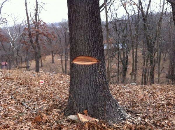

    If you use a Humboldt undercut and snipe it will get off the stump quicker. Might have kept it from coming back. A deeper face would have been ok on that one also. Good job just a few suggestions for next time you have an easy drop to do.

    I'll have to youtube Humbodt and snipe, thanks for the info.
    I was afraid to notch it very deep, thought I might get into the hollow and lose the hinge.

    Notch depth should be about 1/3 of the diameter & at least 45°. ( I like more like 60° for the size birch I typically drop)
    When you see & hear a "POP" when the hinge breaks, way before the tree hits the ground, you need more angle on the hinge.
    The notch closed before the tree was on the ground causing the jump.
    A more open angled notch( near 90°), the tree hits the ground just before the notch closes & the hinge breaks.
    Your low angle notch caused the hinge to break early, so when the top hit the ground it had
    no attachment to the stump so it jumped & the limb pushed it back.
    One of the reasons you walk several feet away as the tree start to go over, even the best cut, thing can & will move.
    But with this one being hollow, you did good, ! ! :thumbs:
    A little bigger angle on the notch is all I see , depth was great due to it being hollow.
    hollow & rotten centers are dangerous , the hinge is only flexible in the live outside wood.
    Search "tree felling", some good instruction & videos out there .

    I thought the notch was always supposed to go down from the perpendicular, not up as fox appears to have it??
    Are both OK?

    The notch can go either way. I prefer it going down (Humboldt) rather than the conventional. There's not much trimming to do on the log to get it square if you're milling.

  14. bogydave
    +1
    I use the humboldt too.
    Saves a few inches of the first round .
    A little more effort to make, not bad though .
    Pushes the base a little away from the stump &
    less chance it comes back when the hinge breaks.

    Yep. Saves the log from being bucked of the last few inches.
    Never heard of the Snipe, but that would seem to work as well. Putting that one in my little bag of tricks. :)

    If you want one off the stump quickly the snipe helps. You can make it almost as big as the face if you want. The block face works good too in soft woods. Never tried to use it in the harder brittle woods.

    The Humboldt is used mostly when felling on a down slope. Most will use the standard wedge for most of the cutting and it works well so long as you do it right. Even with that tree showing some hollow, I would have tried to cut the wedge deeper.
