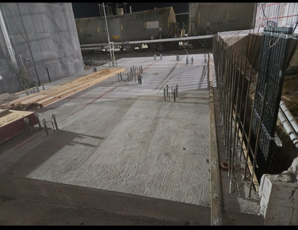

    They have the big base pad poured for the 2 silos now Screenshot_20260628_080338_Gallery.jpg

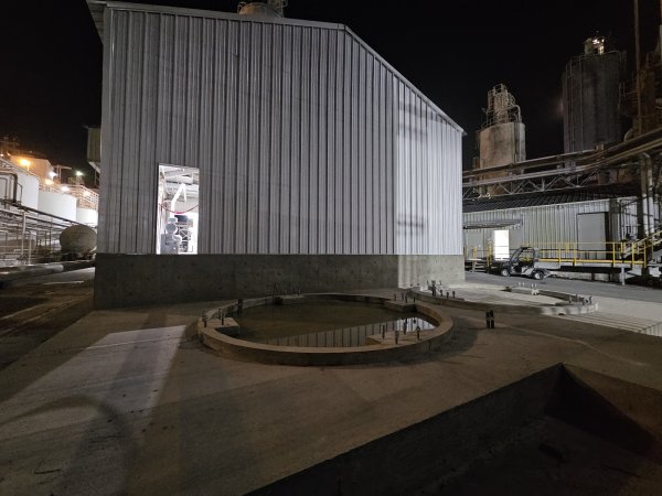

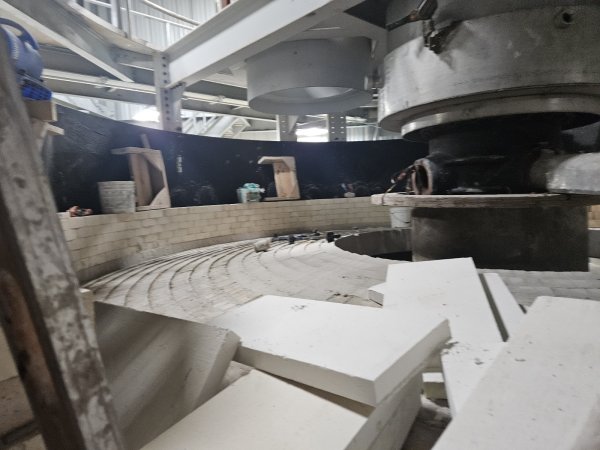

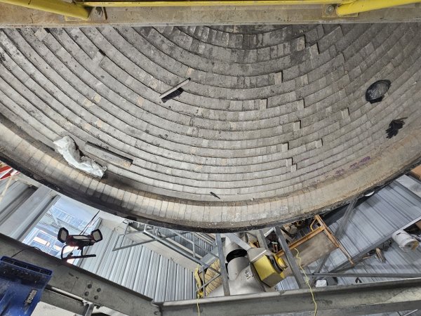

    The calciner hearths are coming along fine. Only 3 more to lay and then the top 20260727_202450.jpg

    Last hearth is done, finish up the wall, and then the top. 20260816_205852.jpg

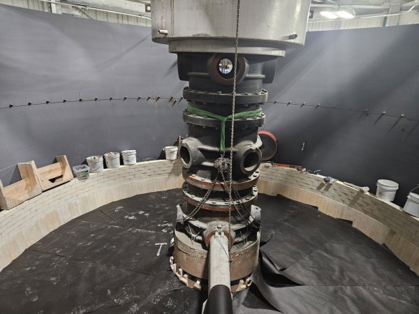

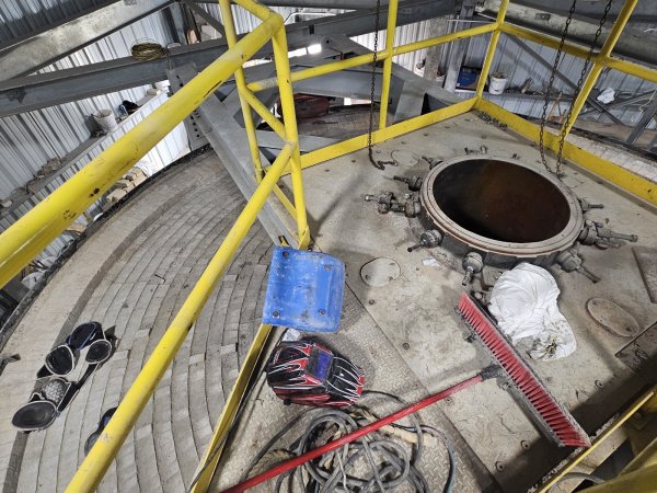

    Had a chance to check out the progress on the new calciner.
    They have gotten the top bricks laid, now a poured mix goes over that ,even with toop of steel shell...hole in the middle is top of center shaft. 20260829_090608.jpg 20260829_090626.jpg

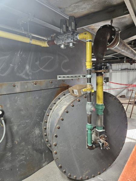

    Getting gas and combustion air lines ran and hooked up to the burners 20260829_091129.jpg

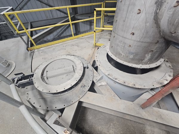

    Big damper to control pressure and combustion gases. Also see the casting inside big pipe. 20260903_021941.jpg

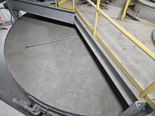

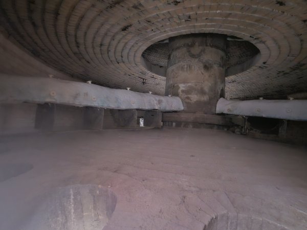

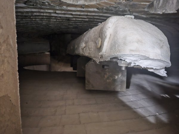

    A good view of the center shaft with arms and rakes attached. Note the openings, top hearth clay falls through center, bottom hearth clay falls through the outside holes. That's the way clay moves through the kiln. 20260903_021629.jpg

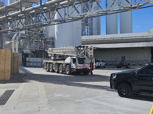

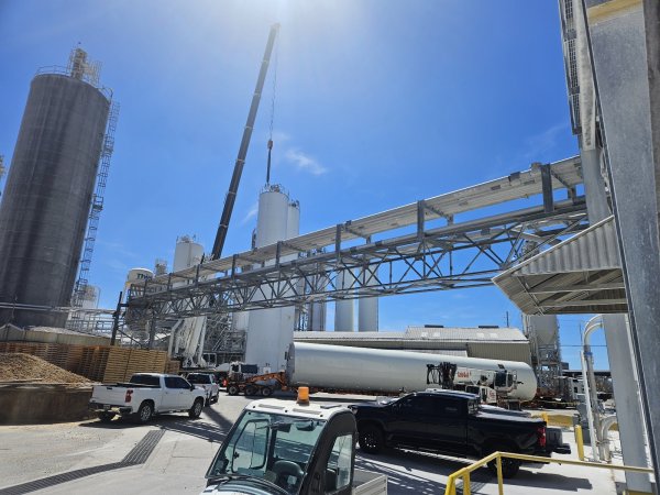

    Backing the trailer in with tank. Rear steering sure makes it easier 20260928_134208.jpg

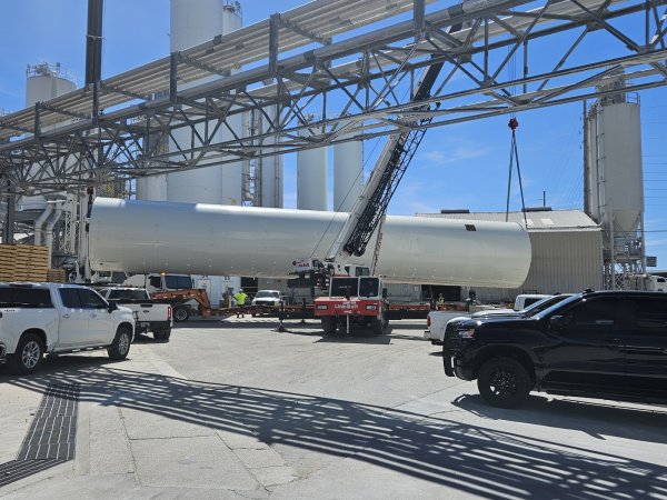

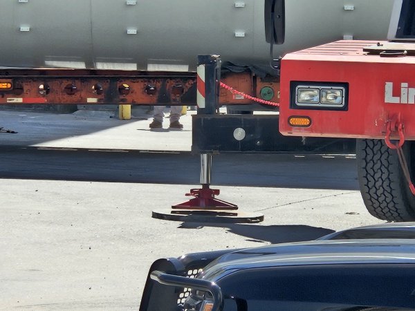

    I noticed the front of the crane moving a bit...Wonder if he had any pucker factor going on...I zoomed in on the front outrigger pad... 20260928_140950.jpg

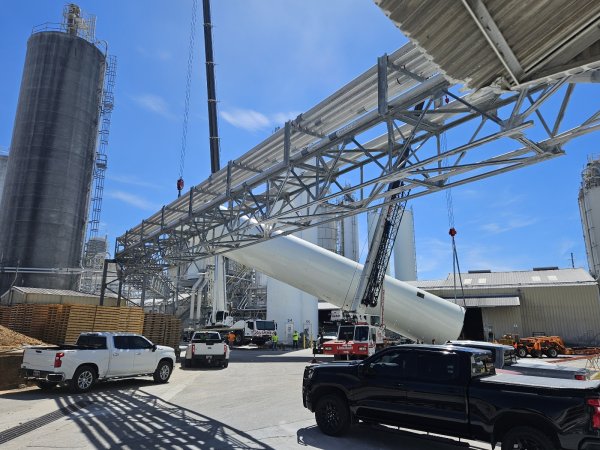

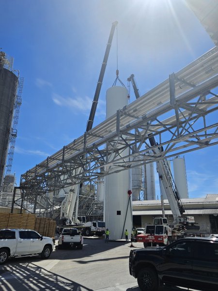

    Trailer gone, now time to start standing it up... 20260928_141208.jpg 20260928_141353.jpg 20260928_141535.jpg

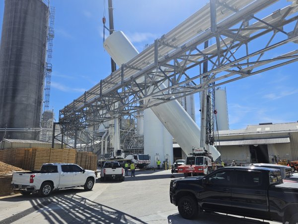

    After taking the bottom braces and lifting plates off, time to lift it up and over to the pad... 20260928_143107.jpg

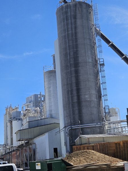

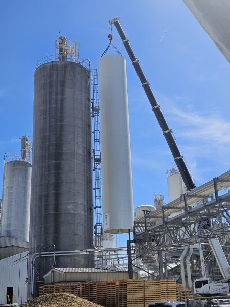

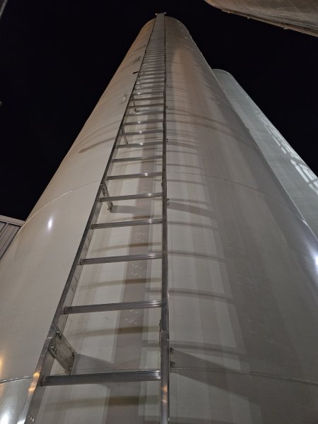

    Sure didn't look that tall on the trailer, but it's up there... 20260930_005417.jpg

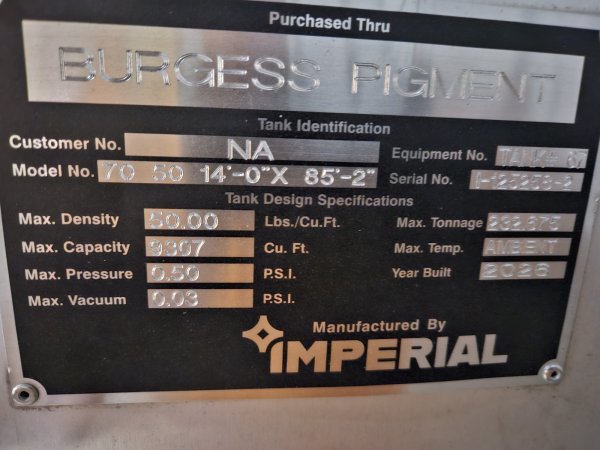

    Another good :usa::usa::usa::usa:built product. Hauled over 1100 miles from WI to GA... 20260930_005523.jpg

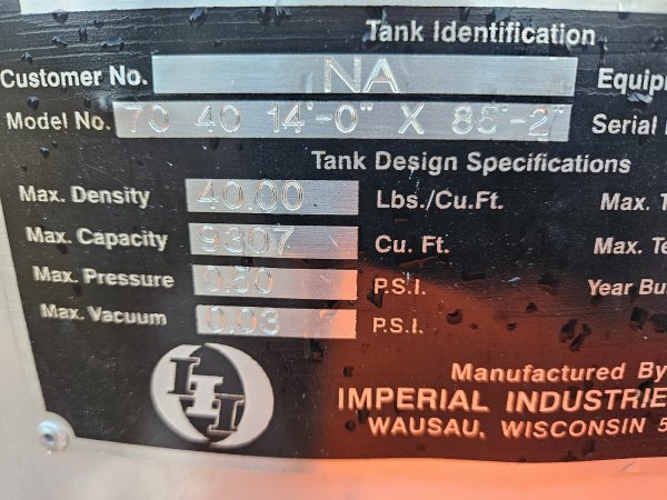

    T.Jeff Veal Where in WI is that tank made?:handshake:
  10. T.Jeff Veal
    29,892
    192,147
    Looks like Rothschild, WI
  11. Erik B
    Erik B
    May 12, 2015
    5,710
    39,547
    Western Wisconsin
    I have driven past that town a number of times when I was still working. I usually had to go to Wausau when I passed Rothschild.
  12. T.Jeff Veal
    29,892
    192,147
    Well, guess they just changed the tag. Different tank, same company.
