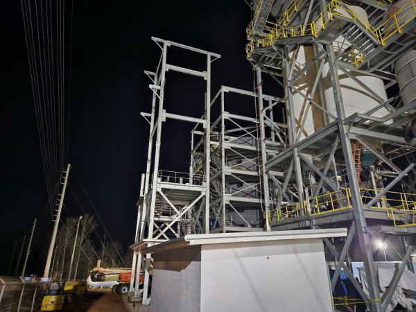

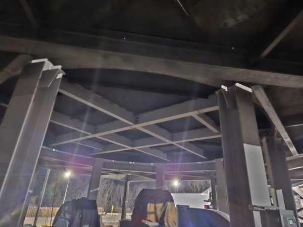

    Built the bottom structure to hold the calciner..legs and beams 20260110_004510.jpg

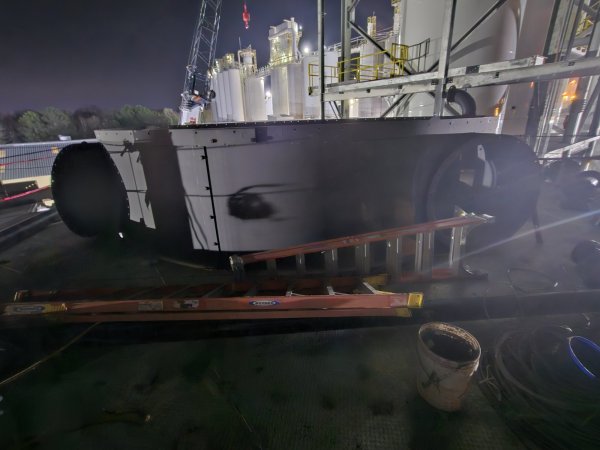

    They have gotten about 2/3 of the shell assembled. 20260110_004558.jpg

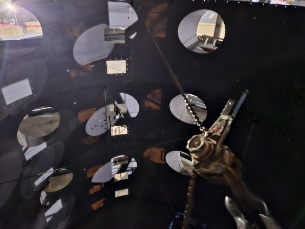

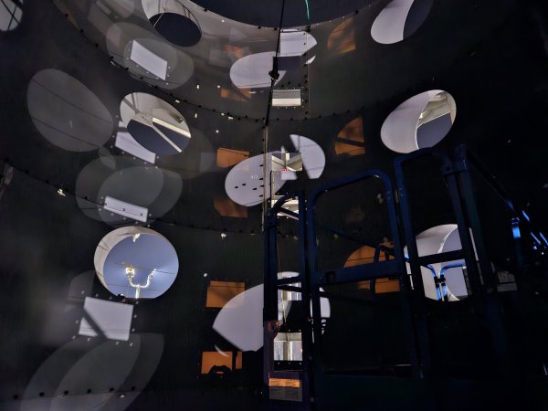

    Still more to go up here...the round openings are where the burners will go. 20260110_005124.jpg

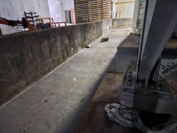

    The other contractor is now pouring the concrete between the building pads 20260206_233352.jpg

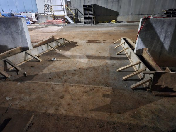

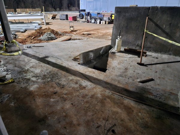

    And put in two access ramps to big mill and calciner 20260206_233426.jpg 20260206_233603.jpg

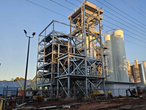

    A better picture of the new calciner system in the daylight. Middle structure is at least 100' tall.

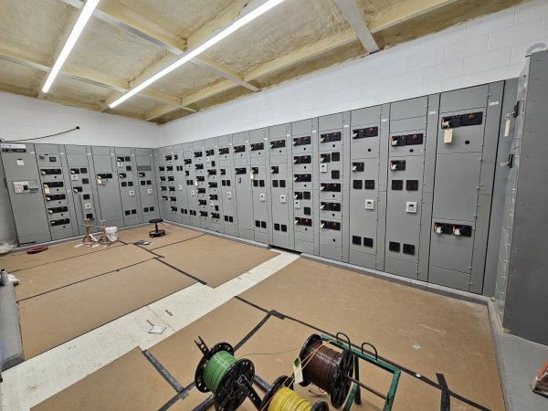

    The motor control room...
    Looked like they had just put some type of sealer on the floor. 20260210_000838.jpg

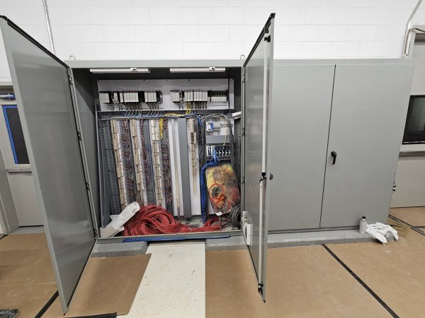

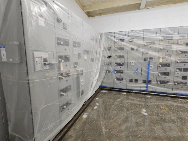

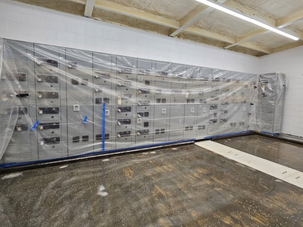

    A couple better pictures of the MCC room. Motor control panels and PLC cabinets... 20260218_234731.jpg 20260218_234704.jpg

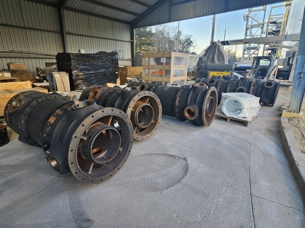

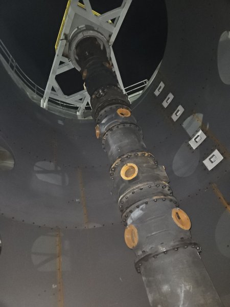

    One of the main components of the calciner came in. This is the center shaft. The arms that move the clay through the calciner attach to this. The design allows cooling air to flow up the center, out into each arm, and then exit out through the outer opening.

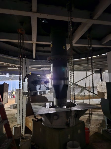

    Bottom pivot sits on oil filled bearing. The stainless flange is the water jacket seal. It bolts to the frame above. It traps and dust from escaping and helps maintain air pressure inside kiln. 20260218_235212.jpg

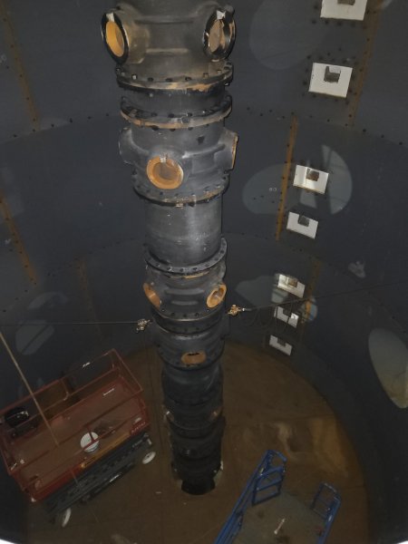

    Getting the sections bolted together. Yes it's big enough for 2 scissor lifts to be inside 20260218_235716.jpg
    Center shaft installed, top bearing and water jacket seal are on the white frame. The shaft is kept in line with set screws that push against graphite plugs... 20260219_211016.jpg

    That last pic looks like a picture from a space station.

    Vertical terminal strips...I like it...ours run horizontal, but this looks cleaner.
    Looks like they are doing a good job of labeling wires...that is key for the poor sap that has to troubleshoot later on.
    We just went through an upgrade of our 25 yo scada system last year...did it mostly in house, with the help of our integrator and his assistant...saved a couple hundred thousand $ over hiring out the whole job. Switched over to fiber optic cables for communication between panels too...that allows for a good amount of expansion in the future.
