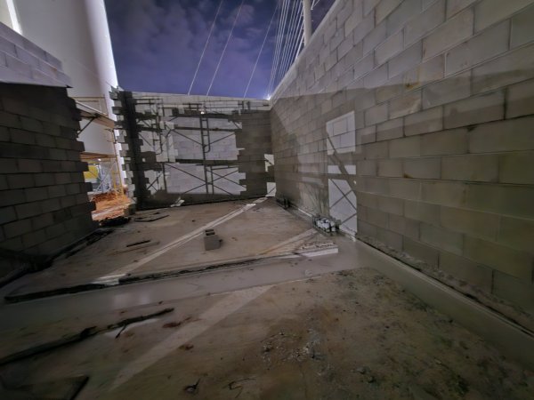

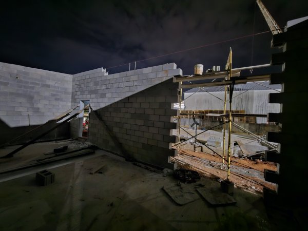

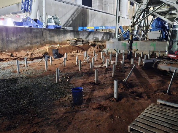

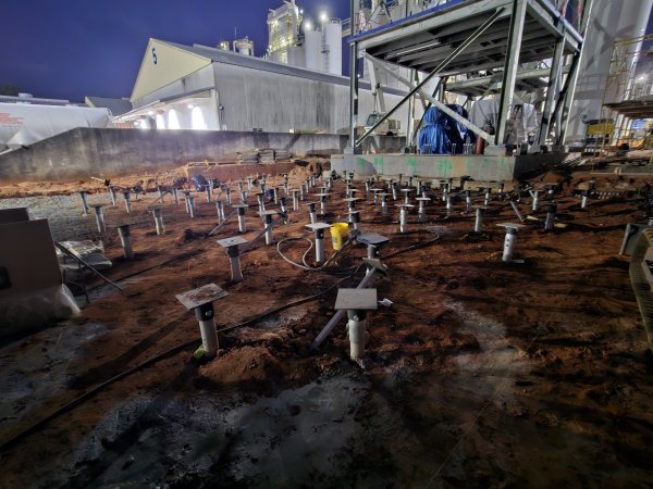

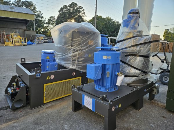

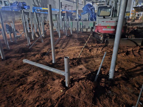

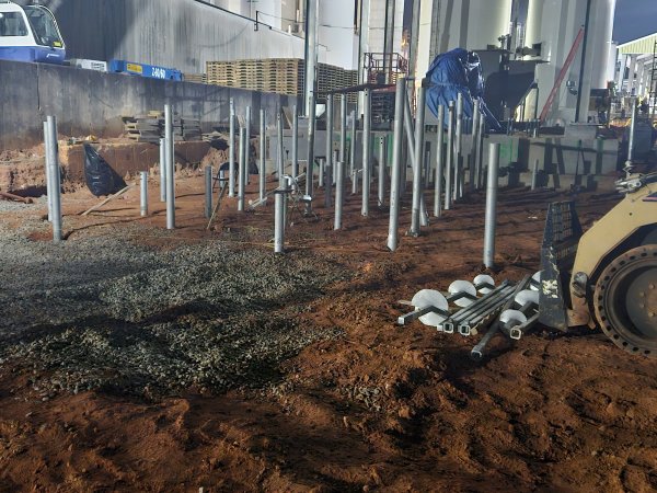

    Came back to work Thursday night after our days off. We've had dry weather, so work is getting done.
    Lot more anchors have been installed 20250919_010900.jpg Started another section of anchors today... 20250920_033305.jpg

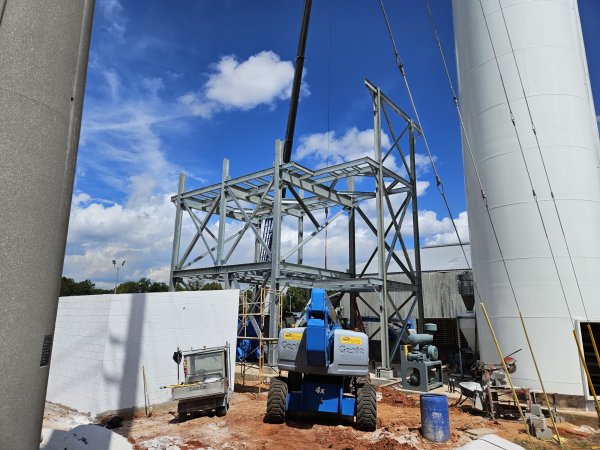

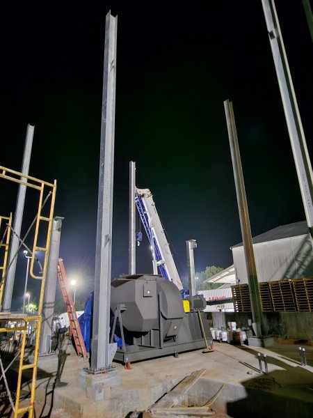

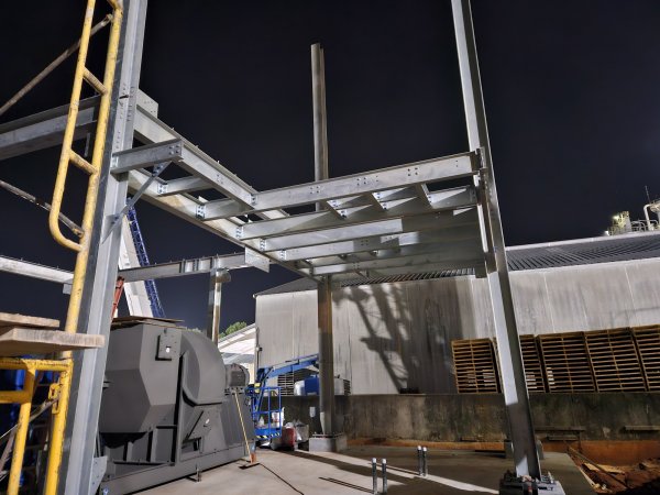

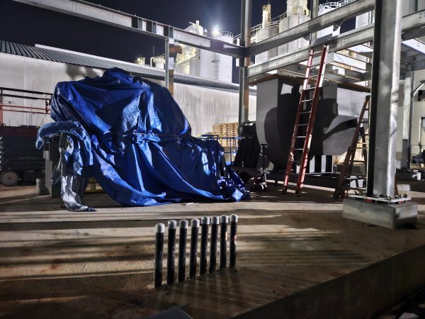

    They have the big fan and mill set on the middle slab... 20250920_033017.jpg

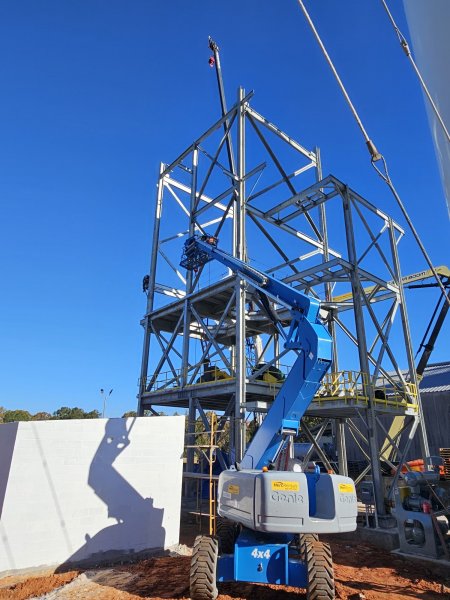

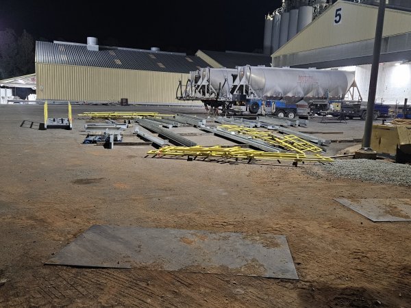

    What is the roots blower for?
  6. T.Jeff Veal
    29,892
    192,147
    We use those with a fuller pumps to move our kaolin clays to different silos.
    All our products are in powder form, we don't run any slurries
  7. brenndatomu
    25,369
    165,324
    We get lime deliveries at work...the trucks all have PTO powered roots blowers to pressurize the trailer, which blows the powder into the storage tower.
    Once in the tower it's gravity fed from there on.
  8. T.Jeff Veal
    29,892
    192,147
    Yep, we get deliveries like that too. Also, ise same set up to unload railcars

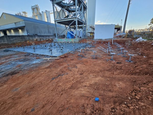

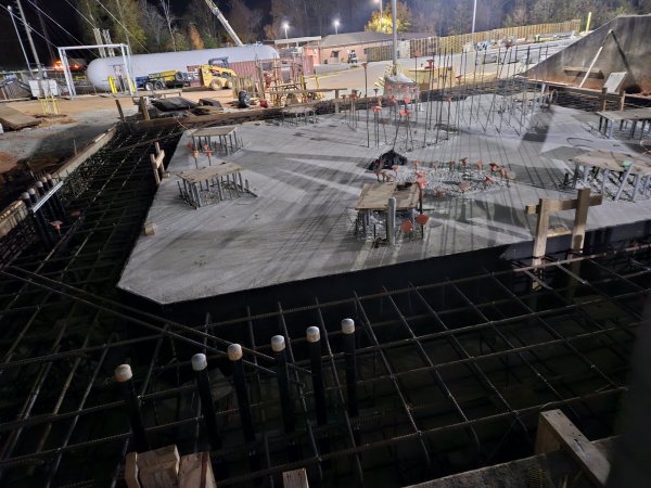

    After returning from our Ohio trip, came back to work and saw they had gotten the caps on the anchors and poured the concrete floors. 20251017_193449.jpg

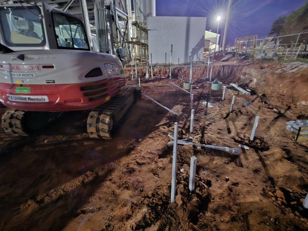

    They have dug out and started installing more of the smaller anchors to the right of the calciner pad... 20251017_193544.jpg

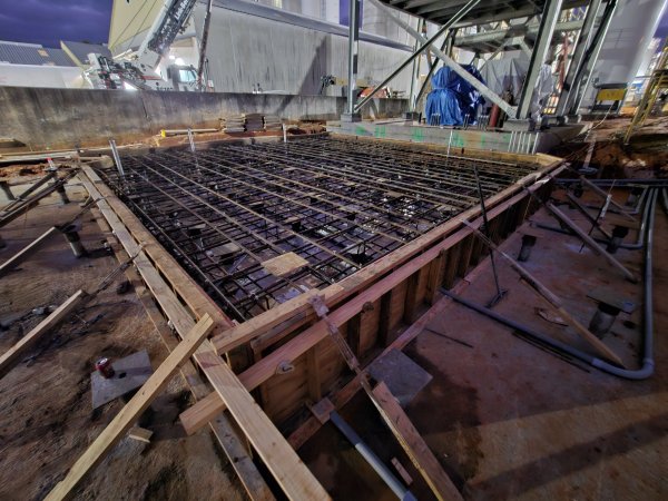

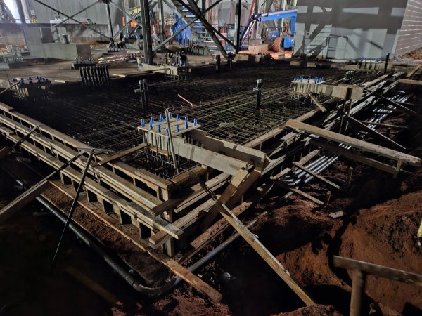

    Looks like concrete will be poured for the main calciner pad soon, got forms, rebar and conduit in. 20251030_191505.jpg

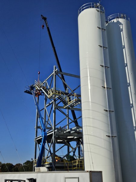

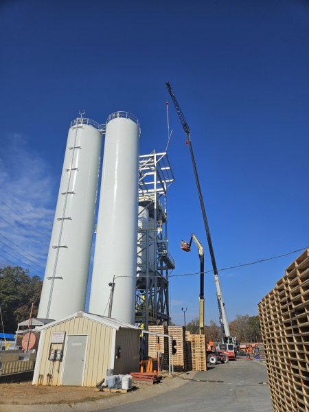

    Off 4 days, come back and they have gotten 2 more tanks set and added more structure above them... 20251116_020455.jpg

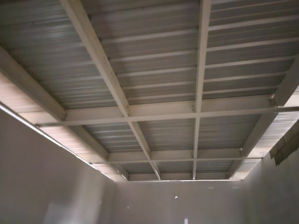

    They built the roof for the MCC room, I guess you could set a tractor on top to work on it...looks like 8 orn10" I-beam and channel iron... 20251119_045223.jpg 20251119_045313.jpg

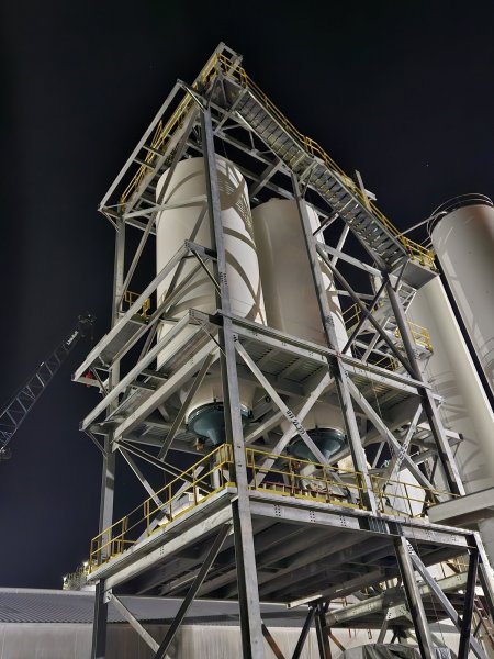

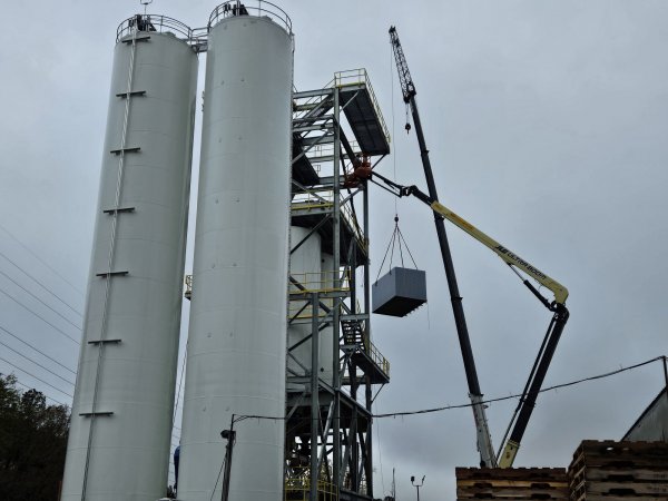

    I believe the main structure is done. They are installing the sections of the dust collectors today. 20251208_090217.jpg

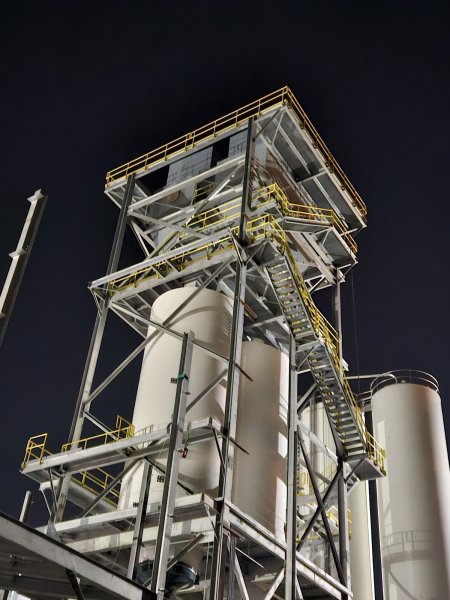

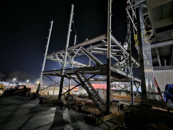

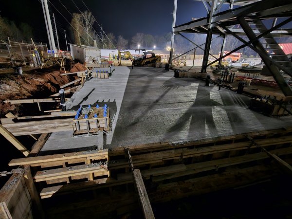

    Got both dust collectors installed on top of main structure, handrails and steps 20251213_010642.jpg
