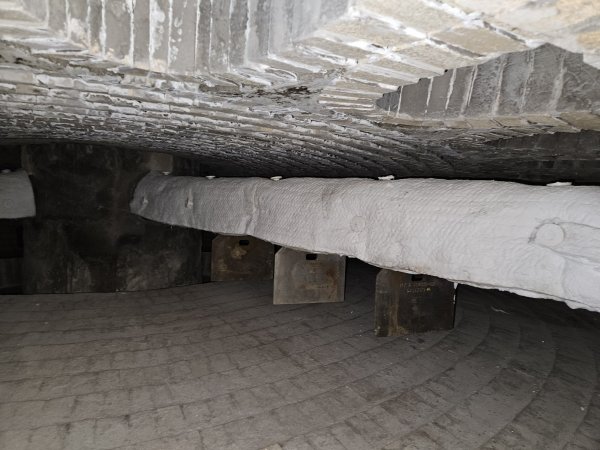

    The crew is finished laying the brick hearths. The top was poured today. 20250423_160638.jpg 20250423_160652.jpg
    Still a ways to go before start-up.

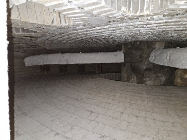

    This is a better view of a completed deck... 20250504_221429.jpg 20250504_221435.jpg
    #5 calciner rebuild is now complete. Burners were lit Saturday, we should start a little feed clay on it tomorrow.

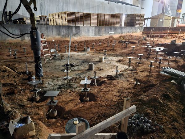

    #8 calciner build site is still coming along slowly. Got a lot of ground anchors done, adding another section now. 20250502_234127.jpg
  3. brenndatomu
    25,369
    165,324
    They start out with burners on low to cure the mortar and slowly bring things up to temp?
  4. T.Jeff Veal
    29,892
    192,147
    Yep, I don't know how low they were over the weekend, but Monday it sat at 1200° for 24 hrs, they put the clay bed in, basically 4.5 tons is slowly added and allowed to make a floor. We put a ramp in today to slowly bring it up to operating temps...50°\hr...then hold there until things get hot throughly

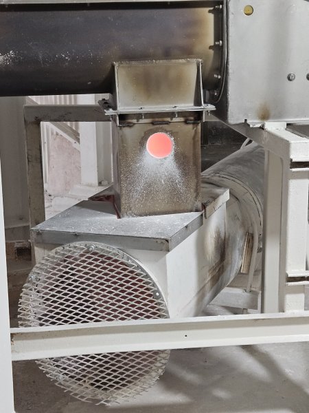

    Put feed on unit this morning...

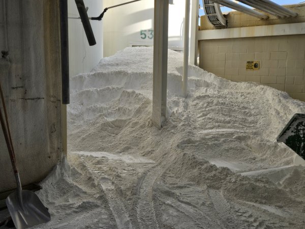

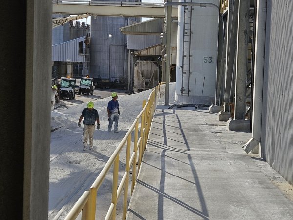

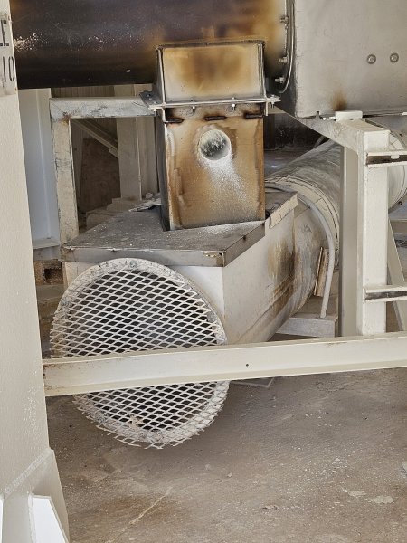

    Some types of expansion aren't good. Got to work Wednesday evening and one silo decided to leak a bit...lol...
    The band between tank bottom and Shaker must have come loose with 30-40 tons of clay in it... 20250528_184615.jpg
    All had to be trashed for possible contamination

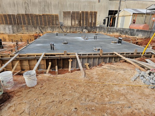

    Good visible progress is happening on #8 calciner build site.
    They have gotten the base pad poured where the ground anchors are... 20250604_013537.jpg
    And now the conduit and rebar for the 1 section is done. A little more form work and should see some serious concrete poured. 20250607_072133.jpg

    We have a finished pad poured...lot of yards of concrete here. I believe this is where the 2 feed silos will go... 20250612_195809.jpg

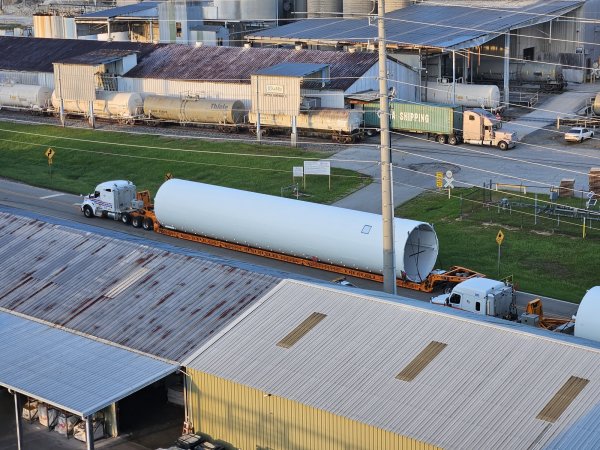

    The area where all the conduit was run earlier will be the MCC building. Floor has been poured and blocks delivered. 20250813_055657.jpg
    The tanks were set up yesterday.
    The tanks had to be turned around, so driver backed down highway 20250813_071937.jpg
    Got turned around in another driveway and backed into our gate. It was cool watching the rear steer trailer 20250813_073851.jpg

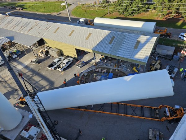

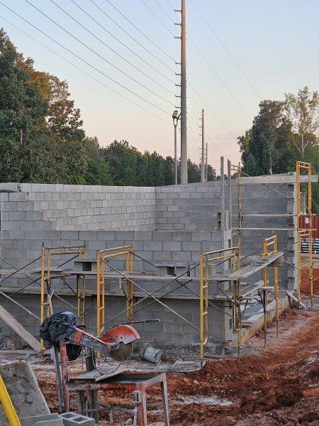

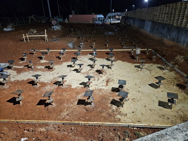

    Continuing top lift, the smaller crane slowly let's slack on bottom and begins to turn 20250813_081439.jpg
    Upright now, taking cables and support brackets off bottom of silo 20250813_081621.jpg
    This crew was done by early afternoon

    They have some really interesting oversize and overweight over the road tractor/trailers these days.

    I looked today, those tanks are 14' x 85'

    Looks like some serious ground anchors are going to be used where the calciner will be built... 20250822_201855.jpg
