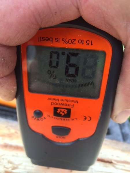

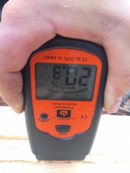

    I had fun playing with my moisture meter today when I was out dropping a tree.
