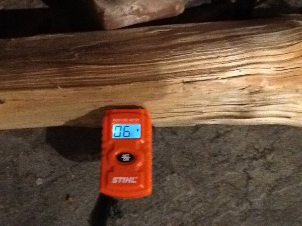

    Hey guys, got my Stihl moisture meter yesterday. I'd figure I test it out tonight, the first pic that reads 18% is from a split from my red oak that was cut down In January. Took a couple of readings on this piece and the readings range from 24% through 18%. (Along the grain)
    And the 2nd pic is from a piece left over for a bundle of firewood from the super market reading 6% (just for comparison)
    I brought that split in the house last night to give it a chance to come up to room temp before taking readings on it.
    I'm not sure what the moisture content would have been right after the tree was felled, but do you think it makes a difference in the moisture content when the tree is cut down in the winter?

  8. Paul bunion
    Paul bunion
    3,396
    13,524
    Green oak is about 85% fresh off the stump which is well beyond the range of a moisture meter. Did you re-split a piece and see what it was on the inside or was that a reading from the face of a split that has been drying? There will be a big difference between the the inside and the surface.

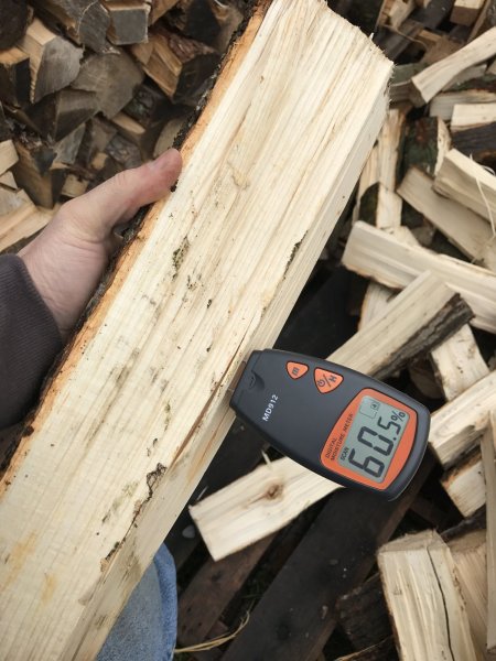

  11. J. Dirt
    J. Dirt
    3,488
    18,346
    Welcome MikeyB! Does that meter have ranges that you select to match the type of wood you are testing? Mine does (not a Stihl) and I'm just curious if anyone has one like mine or if they all have selectable ranges? Here's a fresh basswood split from last weekend after two days of rain. IMG_0974.JPG

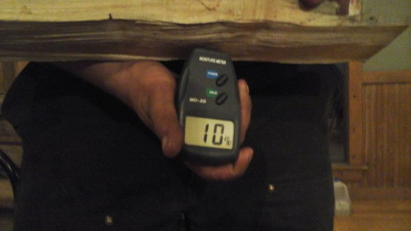

  14. leoht
    leoht
    Nov 13, 2016
    1,069
    10,818
    Victoria. Australia. Earth.
    I have one of these moisture meters.[​IMG]
    It has four modes.
    The problem is I have never cut nor seen any of these species in Australia. It needs a eucalyptus setting. I still use it trying to get a feel for the best setting by comparing fresh cut green versus seasoned wood.

  16. Paul bunion
    Paul bunion
    3,396
    13,524
    Wood dries at the surface. The interior moisture had to migrate thru to get to the surface before it can evaporate. That movement of moisture can be a very slow process and the interior can still be very wet when the outside surface is relatively dry. So what you need to do is check the interior by splitting one again. Being that you say it's 3 months from the standing up on the stump you will probably find the inside to be visually damp. Beyond the range where a moisture meter can accurately work.
