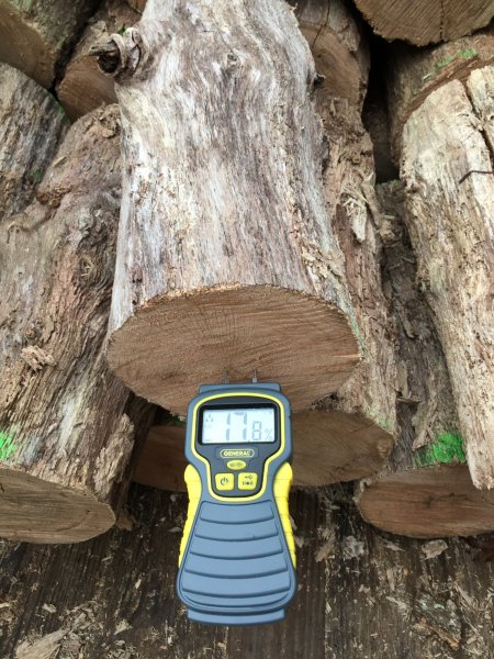

    I was into cutting down dead standing red oak two and three Winters ago a few miles north of gboutdoors (between Long Pond and Silver City Galleria, you could throw a stone to the next dead oak there were so many ) and the oak from about ten feet and higher was all 16-18%. (fresh split, not sticking a end cut ) Dead standing long enough to have no small branches left to contend with. A little punk and carpenter ants in one or two here and there. We had a good bonfire going and threw the wood with ants in it on the fire. It was far too cold for them to move. The rounds from the bottoms of the tree trunks were heavy and soaking wet. Water would squeeze out while splitting. Those were mostly at 20% in two months, even in the dead of Winter. I took all the heavy wet stuff because I wanted it for the next year. My buddy was loading his stove and selling cords. It got me ahead to where I can almost keep up with what we are burning from my own lot(s). I'm still looking for local log loads though. Driving heavy loads 20+ miles was not easy on the truck and we had access into the woods there when it was dry or frozen ground only. Any time it rained we couldn't get in there.

    That's impressive billb3 :thumbs:
    Just didn't want there to be any confusion for members who might have stumbled across the pic and not have a solid explanation... I hope any such folks will read your post:handshake:

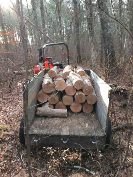

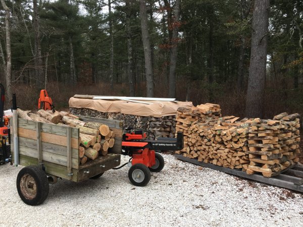

    Yes cut 3 dead standing Red Oak Saturday morning loaded up and back to the stacks to split and stack. Sorry Eric VW but this load was all split and stacked by Sat. afternoon. But I can go stick some of the splits for you this morning .
    Here it is as I am loading it.
    Back at the stacks to split.
    Quick check with the meter. This is less than an hour after dropping it. This was all in a post "oak for breakfast " I did Sat.
