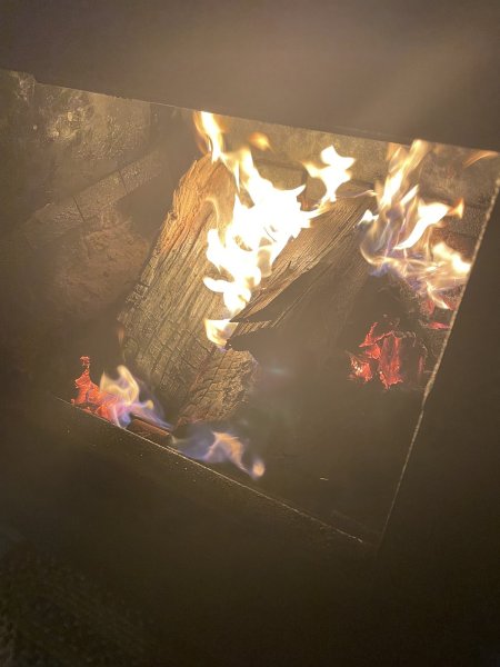

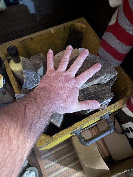

    A forum member on another forum is local to me. He just bought a used BK King model and put a brand new cat in it. He sent me a picture of a milk crate that had 5 medium splits in it standing upright. The top of the wood he covered with his hand...that’s the size of those 5 splits.
    Now I have heard the talk/hype on forums about BK stoves. I will tell you first hand that just being on the outside looking in it is hard to process some of what is written about these stoves...BUT...
    ...I seen first hand pictures that those splits loaded on a bed of coals produced a 24 hr burn and afterwards he sent me a picture with 3 of the 5 splits (though a different load of 5 splits) left and two of them hadn’t even charred on the ends yet... over half of a couple pieces still looked like he just threw them in the stove. If I hadn’t seen the picture I wouldn’t have believed it.
    Edit: He just gave me permission to post the picture. Not sure he is a member here, but he is on hearth.
    Edit:The 5 pieces he showed me may not have been the same as in the picture below.
    The point is you have a metal box inside your home with a fire in it. There are times when you can load it fully, but it isn’t at all necessary with these long burn time stoves and it isn’t needed of you’re the type that likes to monitor the stove.
    Again, NOT saying you shouldn’t, I am saying most times I would not load a stove full. That keeps me monitoring the stove. I’m afraid I would get lazy on a 40 hour + burn. Might be fun to try being lazy though. LOL!

    To say I am impressed is an understatement. Being he is close to me gives me a better understanding of what these are capable of in my own home.
    NOTE:
    The above 2 pictures do not belong to me, but I was given permission to post them.
