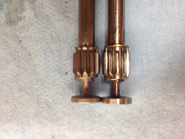

    As I had mentioned earlier in the thread I had just ordered the upgrade parts when Mike kindly showed us how to DIY it. I figured while I had the opportunity I would take a pic of the pump pistons side-by-side to show the difference in angle at the end that he represented with photoshop. Here they are with the HO on the left (sorry it's upside down):

  8. Kg461
    Kg461
    Aug 2, 2014
    652
    1,023
    Provencal, La.
    Sizeable difference in the ramp Id say

  9. NewToStihl
    NewToStihl
    Apr 27, 2014
    807
    2,397
    Central Indiana
    I agree. I wish I had looked at and/or photo'd the difference in the control bolt too...

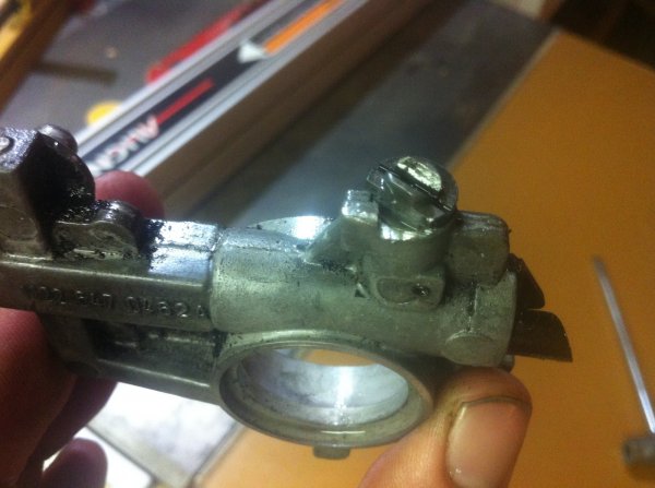

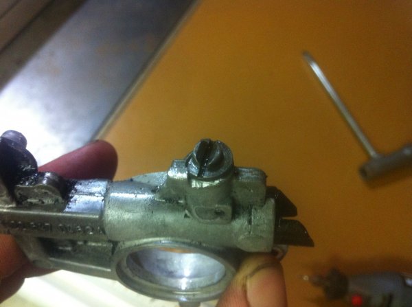

    I tried grinding the stop as Randy suggested, and it did seem to make an improvement on my MS660. I'm sure I'll still need more before I can run that 50" bar, but it got my 28" nice and soupy. I'm going to test it out for the weekend like this.

  11. mdavlee
    mdavlee
    Oct 21, 2013
    4,380
    10,478
    That will help some. Make you an aux oiler for the milling with the big bar.
