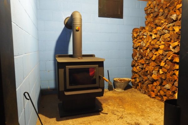

  4. Sequoia
    Sequoia
    Jul 20, 2015
    50
    159
    I see you have a therm on your flue pipe. Does that have a probe? If so, how do you install? Do you drill a hole?
  5. Todd 2
    Todd 2
    Sep 16, 2014
    558
    1,931
    Yes, Its the condar fluegard probe. You can use it on single or double wall. I see you have double wall - drill a 3/16" hole straight in through both of them, then enlarge the outer pipe hole to 1/4" Push the little insert in and then the probe gauge with the magnet. 18 inches up from the stove top. Real easy and works great for lower flue temps that cat stoves run. The instructions are on the back of the packaging also.
