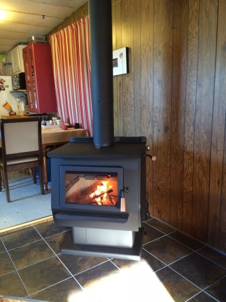

  20. Sequoia
    Sequoia
    Jul 20, 2015
    50
    159
    First fire and then this evening letting her rip. Feels so good in here. Not a day to soon since we're supposed to get about 3-8 inches of snow by Saturday morning. Furnace has not turned on. I'm so happy and so is my wife.
