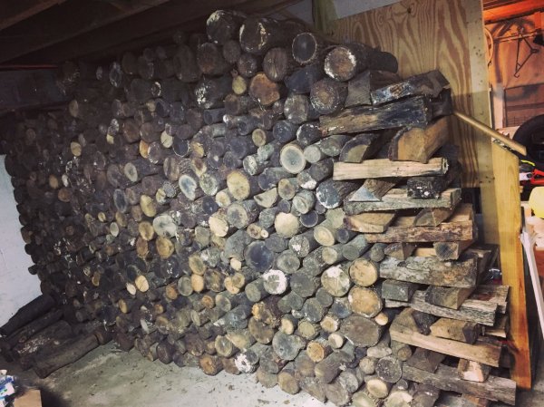

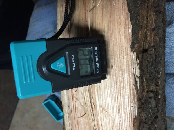

    Needing outside rack space, I moved a row of about one year seasoned smaller unsplit rounds in my basement this fall. I stacked them in the furthest position hoping to burn last and “kiln” dry a little.
    My stove is in my basement to augment the forced air, oil furnace. After stacking, I split a piece and took several readings from my MM. About 30%, taken 10/29/18.

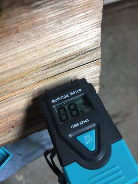

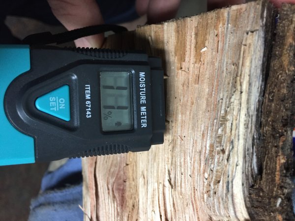

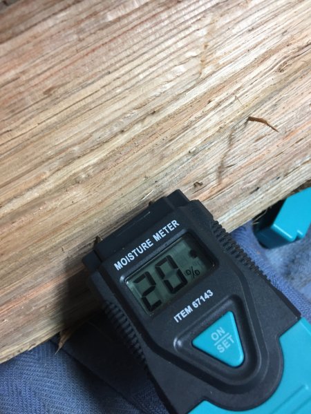

    Fast forward to today. I’ve reached that row and started burning from it last night. I saved the piece I originally split in 2. 1/2’d one and the readings are:
    Not sure if you can tell, but it’s pushed in far enough that I don’t need to hold it. This is only the second time using a MM, so what wood you call that split (besides good to burn)? Huge difference from the end to the middle. This area was not a natural split/check that I followed when I split it open.

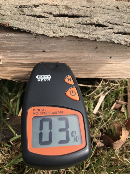

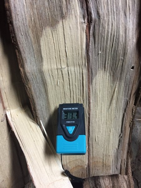

    I also checked a round of oak.
    Same large variance.

  2. Canadian border VT
    19,612
    130,405
    The Wood Wolverine yeah you will find great differences between the end and the middle. Some say you can average the differences. I just go by the middle because it's easier than doing that. Obviously the ends dry faster

    Does it matter if you insert probes parallel or perpendicular to the wood grain?
    Chaz, Felter, Barcroftb and 7 others like this.
  5. The Wood Wolverine
    18,829
    121,184
    Very good question! I wondered that and took some readings both ways. They did vary a few points, not much. Higher when with grain, little less when across.

  9. brenndatomu
    25,094
    163,007
    20% is considered by most to be the upper end of "dry" wood.
    Generally the pins are supposed to be parallel with the grain.
    All these test were done right after re-splitting the wood? If so, you should be fine.
    Another thing you can check is the calibration of your meter...the ones I'm familiar with say to put the pins against your palm (not too hard! :bug: :rofl: :lol:)...the meter should read in the 30% range...
    Chaz, Felter, Barcroftb and 8 others like this.

    Even with the ends being 8 and 11%? The 20 was only around the core. And I'm guessing you say that because of chimney deposits? Like mentioned, I'm a rookie reading numbers on this meter. The true test will be when I clean out the flue this spring but I'd sure like to know what % does what.

    The Wood Wolverine ..the numbers above 8 +11 +20 is 39 divided by 3 or 13. So your average moisture content in that piece of wood is 13%. :yes: This is how my moisture meter told me to get a true reading on a split.

  18. OhioStihl
    OhioStihl
    Oct 10, 2013
    1,562
    9,207
    Southern Ohio

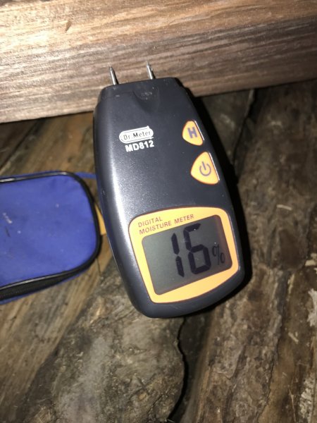

    I have questioned the accuracy of my MM. I’ll take a piece of wood that’s been css for 3 years and spent the summer in the wood shed and test it. If it’s under 20% then I figure it’s close to calibrated.
    This pic was from some wood that’s been stored in a dry basement with a furnace running every winter for 5 years. I have never had a reading that low before.
    Marvin, brenndatomu, Chaz and 4 others like this.
