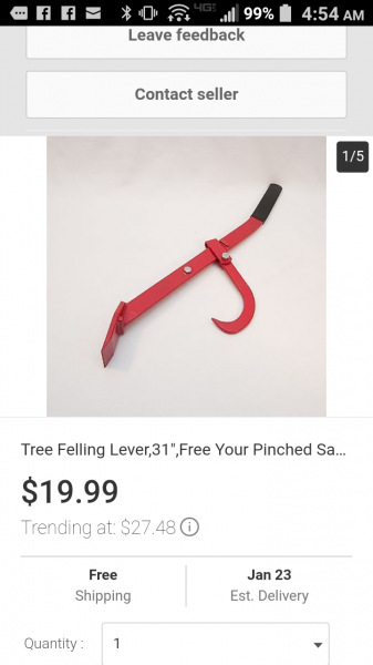

    Just a heads up on the tree felling lever, I bought one last night for $19.99 on eBay with free shipping Screenshot_2018-01-12-04-54-41.png

    I just bought a stihl one today, £50!! I'm now wishing I looked on EBay!
