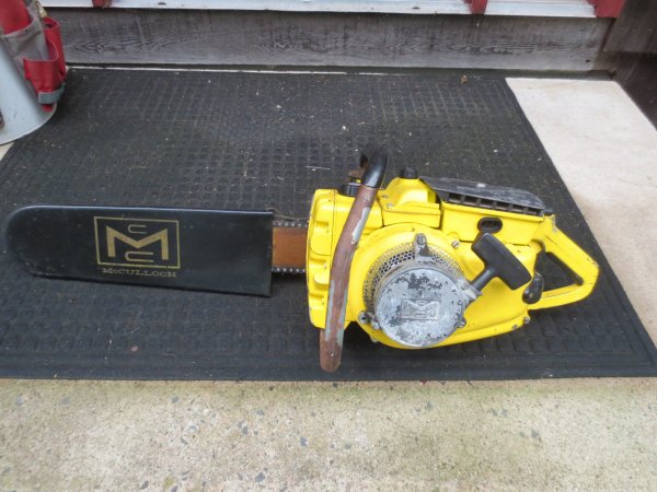

I had a big ole McCullough that had one. Never used it as saw was given to me. Had leather tie straps too. Ill see if i can find the pics.
