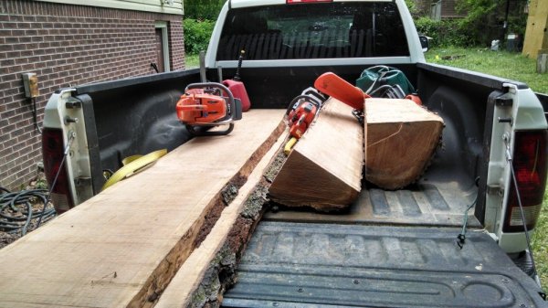

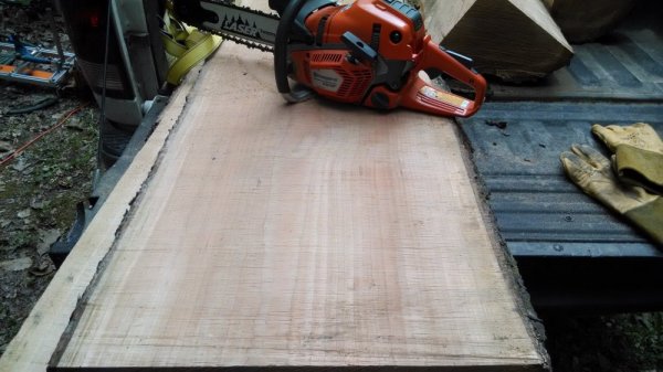

    Cherry from today. Some observations from milling today. I got more bd ft cut with the 088 for the same amount of fuel over the 390. I could barely make a cut with the 390 9' long in the middle of the log. The widest board I ran out 2/3 the way down.

    That wasa good sized Cherry.. Can't wait to see your project. :popcorn:

    The way those look if I get some more time I'll go get some more of that cherry. There's another 6-8' from right above the piece I milled. I ended up with those quarters since it had cracks running down and deep when I got to the 3rd board. I didn't have any short bars with me to mill with so I just tossed them in the truck since I could handle them. I should have took a picture of the log before.

    Those are some awesome looking slabs. Wish I could do that. As a woodworker, I have felt guilty cutting up some nice logs into firewood. (But I get over it when my living room is 74 in February).
