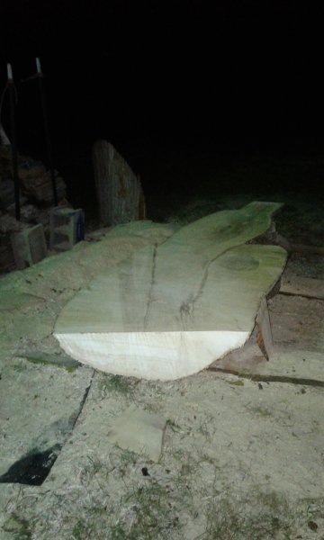

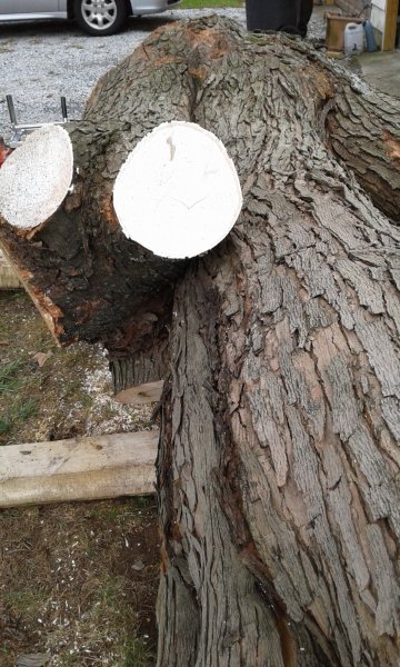

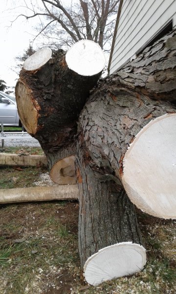

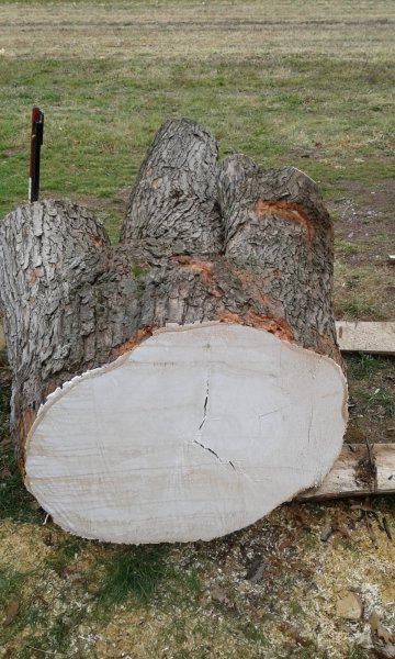

    Well, I rolled it. Those two cracks appear to follow the limb on the right of this pic.
    The full width is too much for what I have so I'm thinking my best coarse of action is to cut @the cracks. Thoughts?
    And of course I already mounted up the saw.
    Insert bang head emoji...

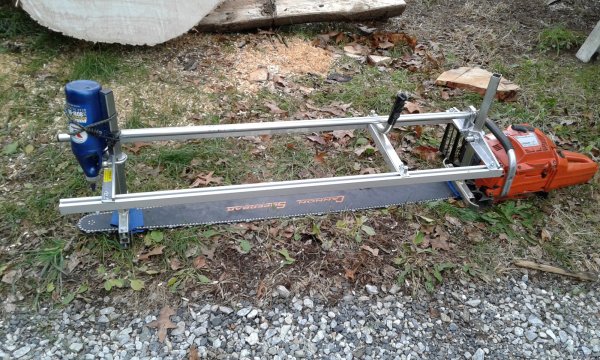

    Got the first cut finished and about 1/2 of a second and we called it quits. Severely dislike that it's dark by 5pm now!
    Man mdavlee that chain flew down through this maple!! I scrapped the bungee idea and had Andy apply oil during the cut. Will have to wait for sunday to finish.

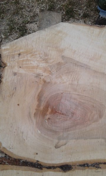

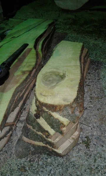

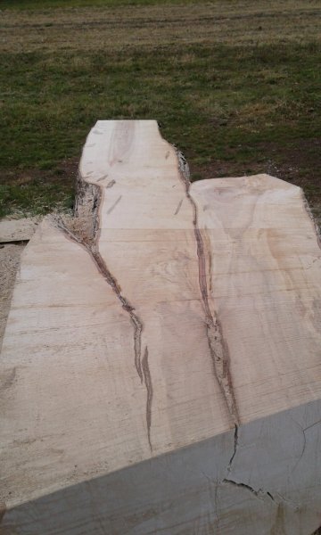

    Finished it up this evening. I'll get better pics when I sticker it up. Not nearly as much figure as I'd hoped for. And if I had it to do over, I wouldn't have rolled it 1/4 turn from the way it sat.

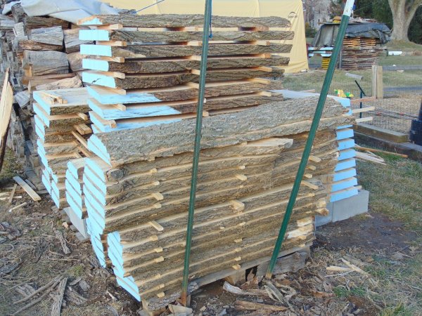

    Dang those are really pretty pieces. I know I'm stalking but this was a big debate and nobody replied the aftermath. I just realized these were done only a few months ago...:whistle: What happens to these now? I now have to admit you're giving me ideas on slabwork but i havent got the right equipment yet. :makeitrain"Gotta make some of that.

    Well, I do not have a solar kiln yet... so these will sit stickered to air dry for a few years. Recommended a year per inch of thickness I believe.
    And some of my others
