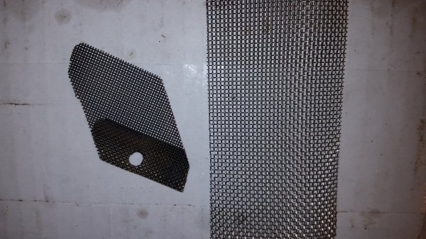

    Thought I should show ya this. One my personal saws I like to keep the protection of a screen cause most of mine just get tossed in the back of the truck. I usually replace the fire screen with some of this stainless screen. This is just a filter screen for like a 2 1/2" strainer. They come round and I just cut the welded seam out and have a nice square flat peice of stainless screen.

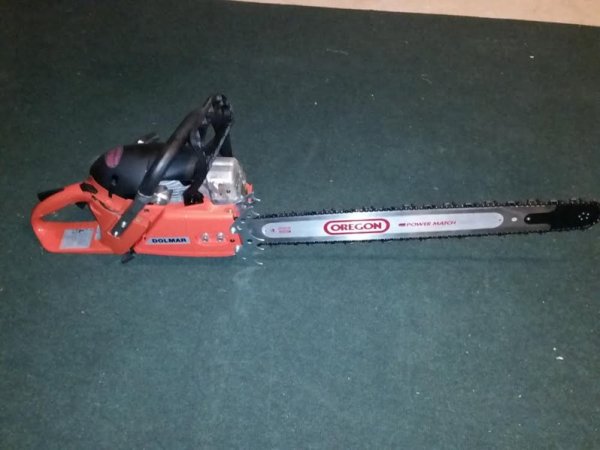

    I had to post this up. The AS member that bought saw 1 made her pretty. Hers a pic he posted of her. Just trying to make Ya'll drewl. :ithappened:

    Ooooooh.. I like it.
    That is a beautiful bar. I am not a huge fan of Oregon, but their lightweight series and that Power match tugs at my strings.
    (Is that a lightweight? Looks like the insert they used on the LW bars? )

    Yes it is!
