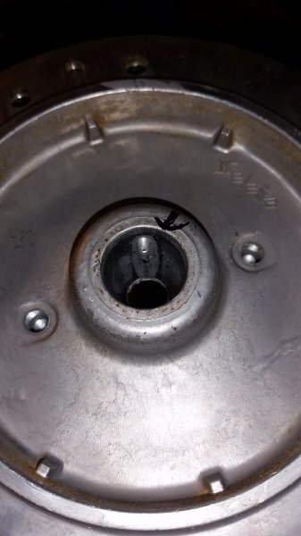

    Ok here's the flywheel off. On the built in keys it's very hard to measure and say file .050 off and it will give u 5°. So the arrow points to the side I file from. This allows the flywheel to be rotated ccw
    mdavlee likes this.

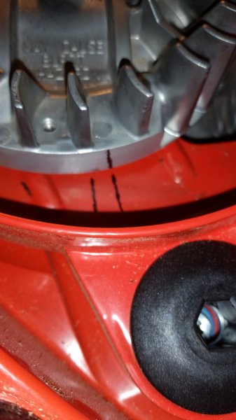

    2,010
    64479
    I put my piston stop in and rotate the engine ccw till it hits. I mark the flywheel and the cases at this point before I file. I then take some off and put the flywheel back on loosely and remark the cases while holding it in the counter clockwise position. I then use my degree wheel and move it between the marks to see how much I have advanced it. I was aiming for 5° and got a little happy. These marks are 6° apart. You can also mark 5° before you start and file check file check. You get the idea. Lol.
