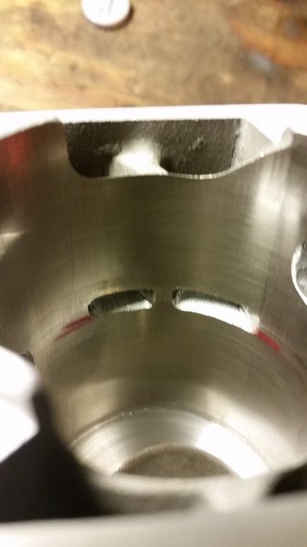

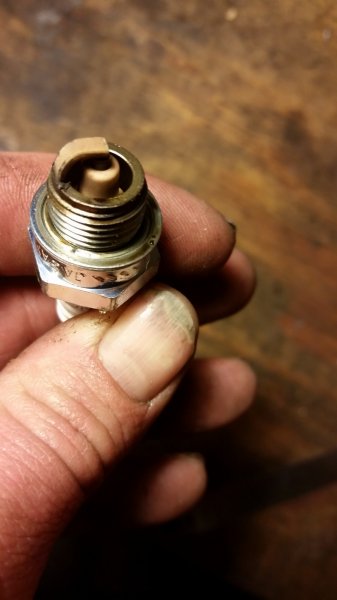

    Started into the stock saw tonight. Squared up the intake and ground a little on the exhaust. Don't wanna do to much till I cut the squish and base. I'm gonna cut it the same as the other one. I thought this saw was running pretty rich when I ran it but the plug shows it wasn't that bad. Lol.

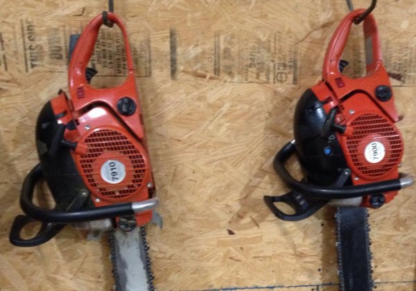

    image.jpg Look at that pair...

    Have both of those had an attitude adjustment?

  4. cgraham1
    cgraham1
    Sep 3, 2014
    840
    3,210
    Nor Cal
    I just need the one... :D

  5. cgraham1
    cgraham1
    Sep 3, 2014
    840
    3,210
    Nor Cal
    I almost forgot... I have another one!

  6. millermodsaws
    millermodsaws
    Jan 15, 2015
    657
    2,010
    64479
    Very nice.
    cgraham1 likes this.
  7. cgraham1
    cgraham1
    Sep 3, 2014
    840
    3,210
    Nor Cal
    Thanks! It's my favorite saw. Your 7910 looks like it runs really strong, too!
    Moparmyway and concretegrazer like this.
  8. millermodsaws
    millermodsaws
    Jan 15, 2015
    657
    2,010
    64479
    Be nice to run them side by side.

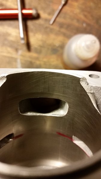

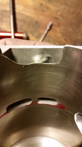

    All right boys. 2nd saw. They said these saws like lots of blowdown so I'm gonna start with 105/135/80. As you can see the trans are right there already. I will make them a flat 135 and square them up a bit. I took .030" off the base and rest the squish.
  13. millermodsaws
    millermodsaws
    Jan 15, 2015
    657
    2,010
    64479

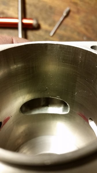

    20150224_172821.jpg 20150224_172810.jpg 20150224_172752.jpg Intake and exhaust are done. Trans are mostly done. Heat shield and gasket are port matched. Muffler is modded but still needs matched to the exhaust port. That's all I got done tonight.

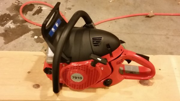

    20150225_172540.jpg Saw no 2 back together. It's snowing and blowing here but if I can talk my wife into when she gets home. May try to go get some times. Numbers are 105/135/80. I have a bar adapter on the way so I can run my bigger stihl bars. Hopefully it'll be in tomorrow

  15. DexterDay
    DexterDay Administrator
    12,411
    31,632
    Northeast Oh
    :thumbs: I can't wait!! That sure is a pretty saw!!!
