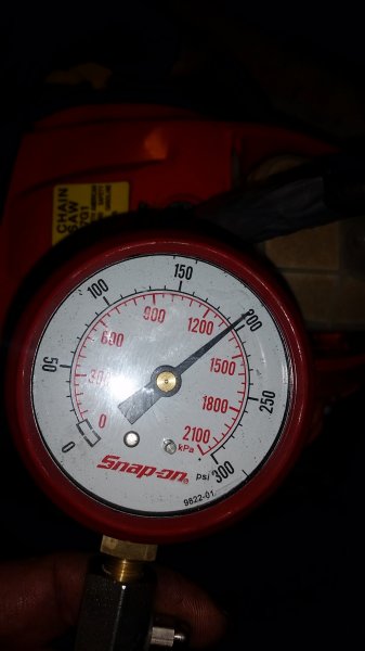

    Final pic for tonight. After about 5 min run time and then letting the saw cool. Here's where my comp landed. 20160115_185141.jpg

    Wow nice work! If I remember right mastermind did one of these years and years ago. Those were some odd numbers. Looks like Echo left a lot on the table with it! Certainly not low hanging fruit though. Made ya work for it didn't it! Can't wait to see you turn it loose on some wood!

    I'm anxious too. I still imagine there's alot more than what I gave this first saw but we will see what we get. IMO this saw needs about 50% gains. This saw is a pooch stock. I would take my 421 dolmar anyday. However. As we see it has potential just gotta find it!
