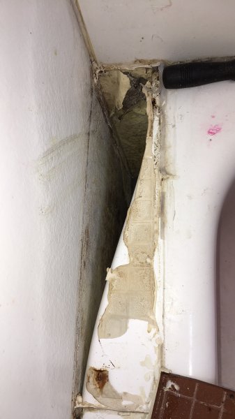

    So I’m likely to sell my house but I found some water damage and had to replace some stuff....anyways water was trickling down the bathtub lip that sits between the cement board. A tile lay here and it was just an extremely wet cover-up. Lead to water coming up through my tile. I bought the house this way but didn’t realize the tile wasn’t sealed up in that space underneath! Grr. 4EC96B03-297B-4CEB-A37E-B3F5C864013C.jpeg
    Anyways tile was put over vinyl which was put over linoleum. I need to continue this later but a leak may be from the shower valves. Any plumbers or someone savvy here? I get water coming out of those valves, it’s a pretty steady stream too. Could this be reason for leak?

    Hmm. I got nothing right now, but I'll give this a bump for you. Do you have any other pictures? Pics of the shower valves especially would help. What brand of valves? They can be repaired with new internals sometimes.
