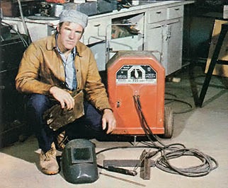

    Oh man, did you open a can of worms! Welding is great big world... First, I'm a high school / college welding teacher by trade so I get this question a lot. Second, especially in the welding world, you get what you pay for. Third, welding is a skill, it takes practice, a lot of it! I have a whole bunch of kids who want to be Beethoven and Mozart, but don't want to learn how to play a piano.
    Those little flux core machines are cheap, but very limited in thickness. Think welding up your muffler, grandma's wrought iron stair railing, etc.
    One super critical point to make... Because you are laying a weld bead does not mean you are welding the parts together! When you weld you are fusing the metal together. You can lay a bead that doesn't actually fuse the two parts together. Think glue that doesn't hold. image.jpg
    For the average guy the best bang for your buck is a little "buzz box" like the one in the picture.
    Is it harder to master? Yes.
    Can you do it? Yes.
    Can it weld most any kind of metal? Yes.
    Can it cut metal? Oh yeah.
    Doesn't it need like crazy wiring? No, same as for a electric dryer 240v
    How thick of metal can it weld? As thick as you can get your hands on...
    Check CL, these can usually be had for $200 or less. Here is a hint, the older the better... Oh, and try and get a machine that will run both AC and DC, that will come in very handy later on.
