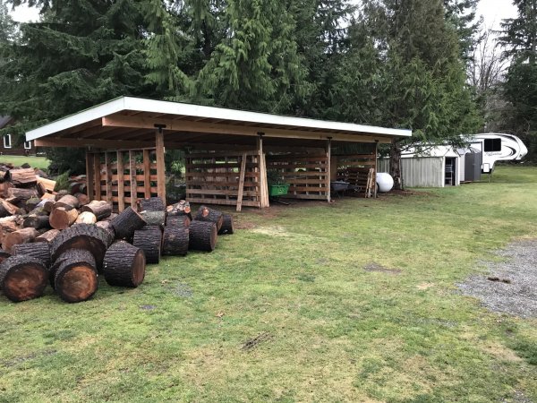

  20. Dstrick
    Dstrick
    Sep 20, 2019
    167
    1,208
    Maple Valley, Washington
    I re-built my shed. This is now a 20 cord shed. It will end up with a metal roof but with a vapor barrier on a OSB deck. 42B86D17-B1FB-439B-8836-B1828FAEED64.jpeg
